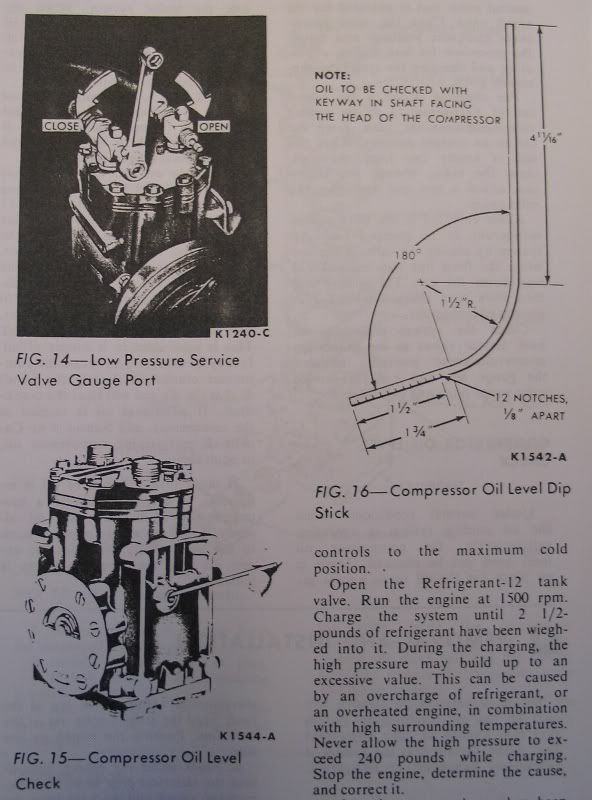

There should be 7/8" to 1-3/8" of oil if the compressor is mounted vertically, or 15/16" to 1-3/16" if mounted horizontally. To check it, you need to make a dipstick to reach in through the oil filler plug on the compressor.
Note: the bend is 110 degrees, not 180
