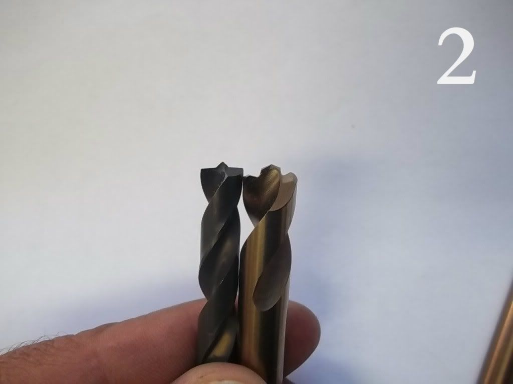

Spot weld drills are the cleanest way to remove the spot weld. There are a few different kinds with each one having its good and bad points. I will sometimes use a few different ones on your typical large job but you could do it with any one of them. Here are a few examples of sizes and styles. (photo #1)
One of the big differences is the pilot tip of the bit as you can see in photo #2, the one on the right has a much larger tip. The spot weld it drills out will have a hole in the center of it. (photo # 13) Now having a small hole isn’t a big deal as you may choose to weld thru that hole (making it a little bigger first) from the backside into your new panel. Why drill a hole in the new panel for the plug welds, when you have these little holes in the underlying panel anyway?
Where as the smaller tip still will put a hole but not quite as big. (photo #12).
The smaller tipped one is a little more precise a cut, the larger tip is a more of a workhorse. It will allow for a lot more error in your drilling skills. If the metal isn’t perfectly flat, if the spot welds are rough old technology welds, the one with the longer tip is going to last a lot longer and do the job with less headaches as it won’t wander. If you have smoother spot welds and would like to use the one with the smaller tip I recommend a drilling a little point into the center of the weld with a 1/8” bit to help the spot weld drill stay centered. (photo #10)
There are spot weld drills with even smaller tips. For the smaller pilot tip you need some kind of tool to hold the bit perfectly straight. There are a few like the “Spotle”, Blair, and some cheap copies. I have a Spitznagel that I wouldn’t give up for anything. This isn’t a tool for the home hobbyist at almost $1000 with the extra clamps I have, but man oh man is it a must have for the pro. (photo #3) It drills out the welds effortlessly with just the pull of the trigger. The tool clamps it’s self, trapping the weld, the bit then extends out and drills the weld with an adjustable depth! (photo #4) You can drill out weld after weld with lightening speed because you don’t have to think about drilling too far or too little to remove the weld.
It leaves the smallest hole in the underlying metal. (photo #12a)

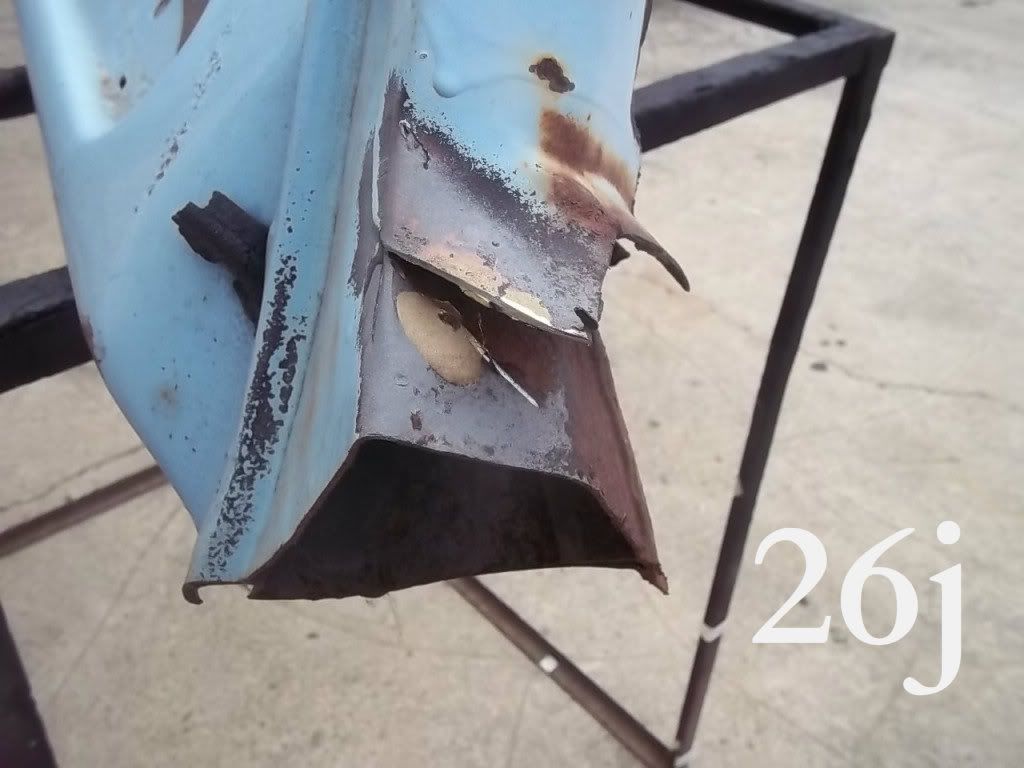

How about a brass tacked panel. This is common where a tack of brass was applied right at the end of panel for added strength. This is an old Rambler “A” pillar but I have seen brass like this on many cars over the years including late models. A 2000ish Toyota Camry has a tack of brass on the upper quarter at the C pillar. Again as photo #26f shows one of the options on dealing with this brass. I simply cut above it, if the upper piece is being discarded anyway, why ***** foot around, just cut it off. Photo #26g shows it split apart easily. Then in photo #26h you can see that I cut away the little piece that remained. I cut it with a cut off wheel and the die grinder, reducing it to just the brass. Then I ground the brass off with an angle grinder and a 3” 50 grit disc to get it down to the metal but not trying to remove it all, you don’t want to grind all the metal away. I then changed to a 3M “Surface conditioning disc” and simply removed the brass with it. The Surface conditioning disc will remove the brass as it is softer than the metal around it.
The other way of course would be to cut thru the middle of the brass at the edge of the metal. The brass flows out and under the panel like glue so you aren’t totally separating the panel from the brass as some will remain between the panels but that is what your panel splitter is for. (photo #26i) And with a little separation help from the panel splitter and you have photo #26j. A little grinder and Surface conditioning disc and you would have shiny metal with the brass gone.

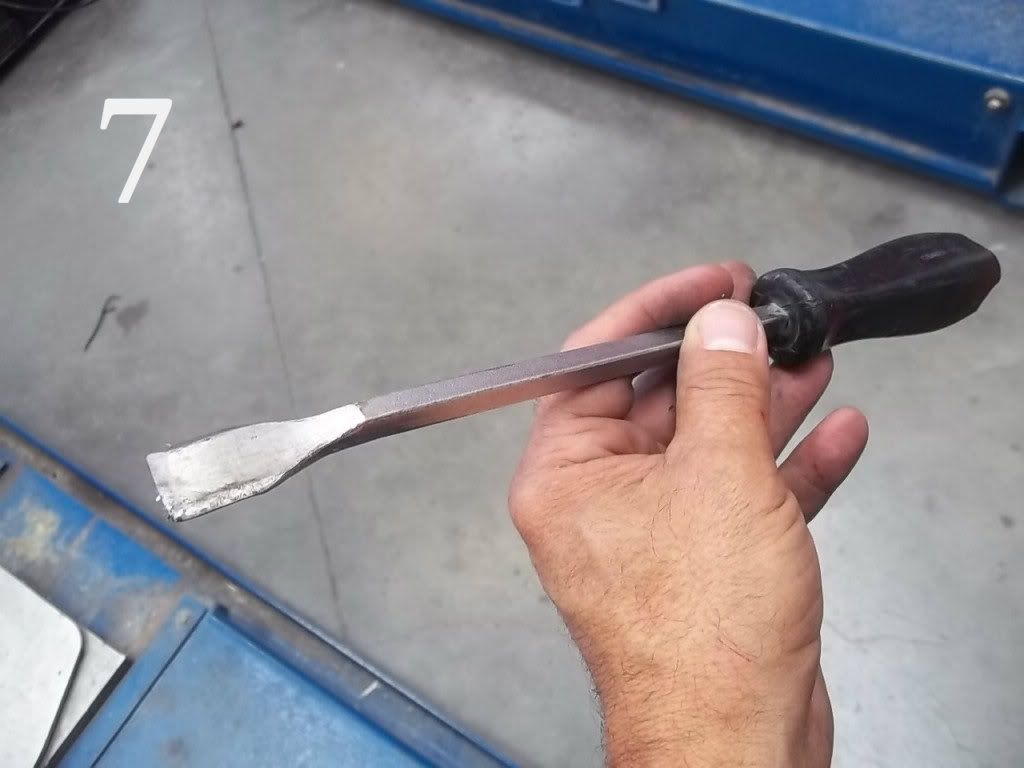

So on to actually splitting the panels apart. My favorite panel splitter of all time breaks one of my biggest rules around my garage and home, using the correct tool for the job. Few things aggravate me more than seeing a tool of mine misused, yet here I am misusing a beautiful Snap On gasket/carbon scraper (Photo #7). This is a very old one, been using it for decades. It’s part number is CSA12-A and can be found used on ebay and such for about $20. I have seen it with and without the A at the end of the number so I am not sure if it is still available using that number. Mine has been beat on for decades with a hammer, it has held up well and I have found it to be the perfect tool for this job. The so-called “panel splitters” that I have seen sold are all much more clumsy, made of thicker metal and just not as good as my Snap On gasket scraper in my opinion. I also modified it by grinding the sides to a blade just as the business end of it had. (Photo #8). This allows me to push it in between panels sideways to get a better shot at a weld, more on this later.
Photo #9 shows my “splitter” being pushed right in to that spot weld without even hitting it. This is how a lot of welds will split when using a quality drill, the weld is removed and I simply pushed my splitter in between the panels without so much as a grunt.

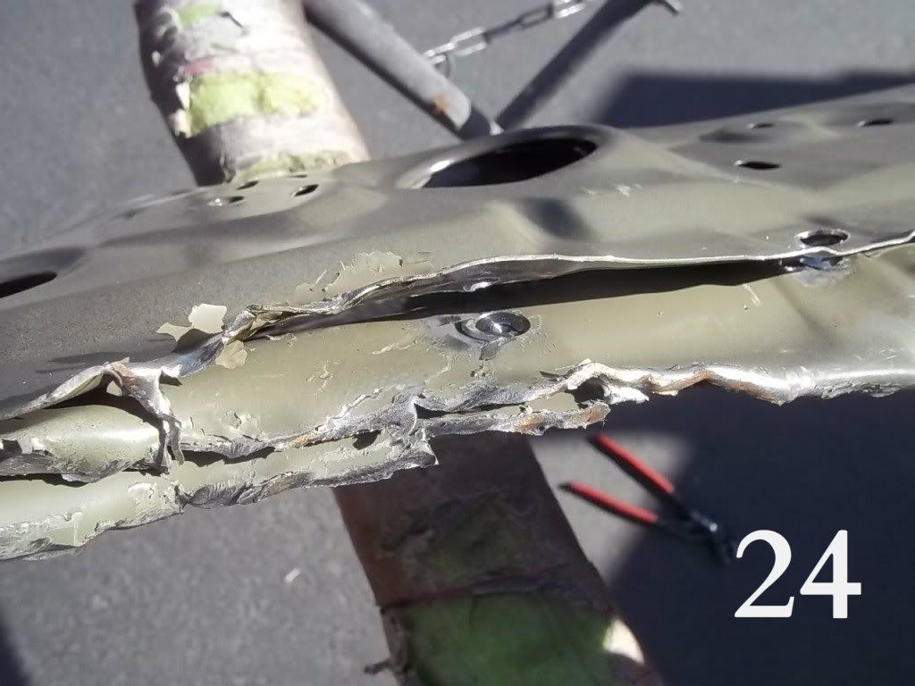

Without a doubt, the most important thing when splitting the panels is to go from the correct direction into a stubborn weld. When you have a little weld still hanging on you need to come from the backside of it. (photo 22a)
Doing this will break the grasp of the weld without tearing the surrounding metal. When it does tear, it tears INTO the drilled out area. It takes a little practice but you will quickly learn which way to place the splitter, upside down or right side up. With the tool sharpened so that one side is flat, this gives you a lot more control and options. You usually want to place the flat side up against the part you are cutting off, which is the part with the hole drilled in it to remove the weld. That way the tool is cutting up at the top of the spot weld and it will tear the metal INTO the hole you have drilled.

But do it wrong, go from the other direction, it’s a whole new ball game. (photo 19a)
Let’s try another spot weld drilled a little off, this time we will go from the wrong direction. (photo #19) Now here is the splitter after it was hit from the wrong way in figure #20. And photo #21 shows you from the bottom side what happens. The metal split because the spot weld at the edge of the hole was stronger than the metal around it.
