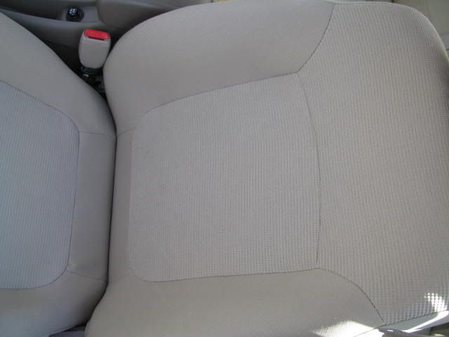

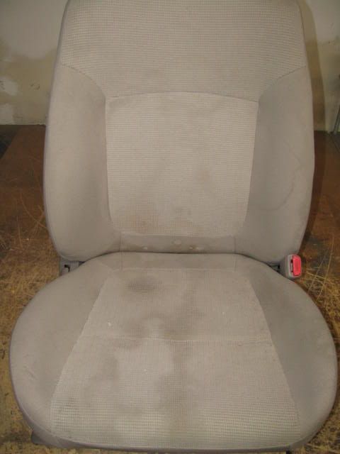

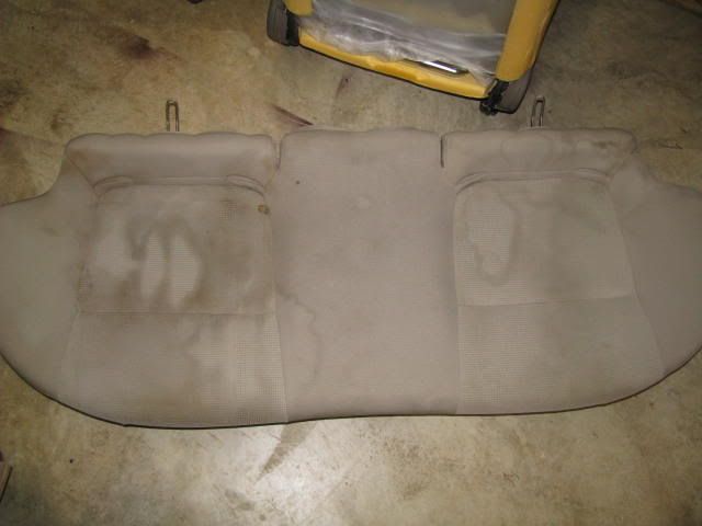

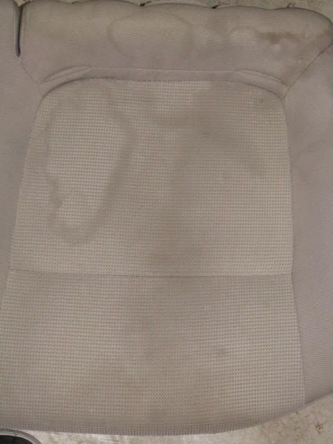

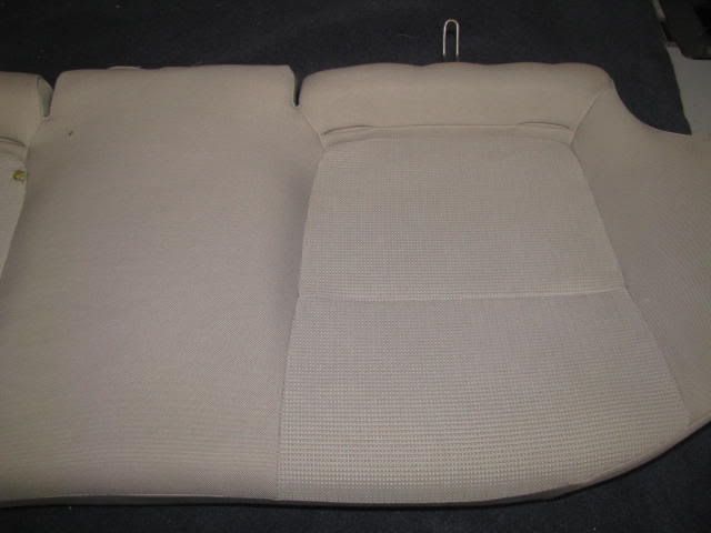

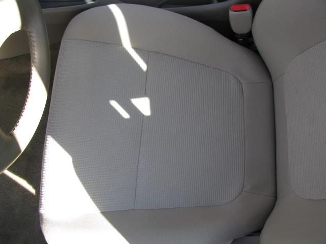

anyone out there have new F-150's or dodge rams or any kind of jeep with there new "green" material..they say you can take a new jeep and run it threw mud and hose it off and its brand new again...welll its not....but this is a fairly simple way to get these types of materials clean...taking the seats apart...spraying them with shout...washing them in the washer and hanging them to dry...we do 3 to 5 a week...this is a 2004 sonata we did today...
by letting it air dry and not dry in the dryer it doesnt damage the materials in the seat...this is a cheap and fairly easy way to detail cars in a way most detail shops cant...doesnt hurt to be ahead of the game! hope this can help someone...
