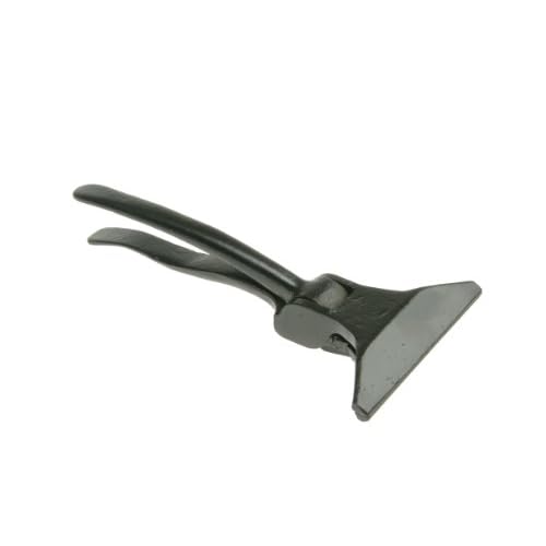

By the way, I got one of these "seaming pliers" at a garage sale years ago. I use it on any flat areas on the door skin like at the top or bottom, and even on the sides on some. These are exactly the ones I have but the same idea. I couldn't find a photo of the ones I have. These things are a MUST for the tops where you can't swing a hammer. And YES, they are VERY different than "duck bill" vice-grips. They are like a "vice" applying more even pressure instead of like a "hinge" action like a vice-grip.
See less See more
That photo shows a pair of flanging pliers that actually work more like the vice-grips and a "hinge". This pair is like the ones I have with a "leverage" mulitplying system. The photo sucks but it is the only one I could find. They are about three inches wide so you can fold a large area without marking it. Just like the hammer and dolly method you go a little at a time back and forth until you can press the hem together firmly.
They work GREAT.

Do you have any idea on who makes that neat litte seemer? Normally I can fold over enough of the skin with a hammer and finish the job with a pair of knipix pliers.
http://buy1.snapon.com/catalog/item...id=757&supersede=&store=snapon-store&tool=all
But those look like it would do a much neat job.
Eric, with as nice a job as you are doing it will blow your mind at how much better these hand seamers are over what you are using! They are like magic, remember the Spitsnagle spot weld driller. :)
I'll get the name or search a little more on google. I posted a photo of it a few months ago and found it easy. I don't know what I am doing wrong. But, I'll take a trip over to the hardware store and see the brand name (work is all locked up). They are for sheetmetal ducting work. Maybe in the catalog..........got the number, (Click here)
And click here for six inch wide ones.
