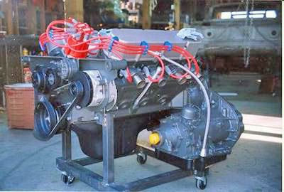

This is the 400 tailshaft mounted to the Toro drivetrain. It allows a normal drive shaft to be bolted to the trans output shaft of the TM400 tailshaft.

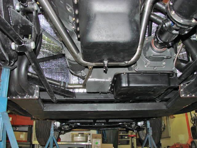

Here is a bottom side view of the drivetrain, note the drive shaft on the right side of the picture coming out of the Toro tranny.

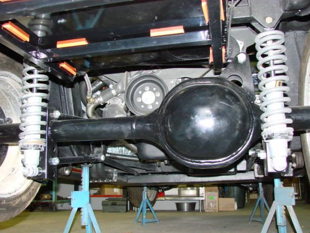

And finally the differential photo which places the differential fully in front of the Toronado engine with suspension attached.. This car used a solid differential but I think for the Cord conversion the suggested independent suspension of an older Vette design would work best.
This would easily work to replace the Cord drive system. Still lots of work but it CAN be done. Lots of engine options but the easiest is to just bolt the 455 Olds or the 500 Cadillac engine to the Turbo-Hydro THM-425 and make it run.
Martin, YOU can tell him NOT to do the swap. I am going to advise him on HOW he can get it done and end up with a more modern engine/drivetrain and enjoy his car the way that he wants it to be. His money, his time and his car. If you don't want him to HotRod it, then buy it from him with a $$$ offer that he can't turn down, restore it yourself and stick it in your living room!
Don't forget that you have to flip the differential over to maintain the forward drive speeds because you have reversed the direction of the ring and pinon by mounting it backwards.
I would say that doing it this way it would be possible to make minimal changes to the original Cord frame and suspension arms etc... It could probably be done so that the car could be restored to its Factory drivetrain later to restore its value. Aluminum motor/Trans mount plates could be fabricated that would minimally impact the frame tubes and there is no need for the complicated "modern" electronics beyond maybe an HEI and MSD ignition system. Same with the Vette differential. Use adapter plates rather than going wild welding in new frame members. Plenty of room there for the big Olds/Caddy engine and if you need a smaller engine, the small block Chevy can be adapted to the THM-425 tranny.
