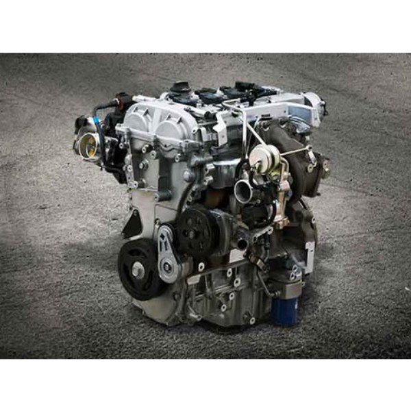

The GM LTG 2.0 turbocharged engine (not to be confused with the "122" engine) is not available as a "crate engine" anymore, but IS still available as a service replacement engine. i think this came in the cobalt SS etc. and i think comes in the new base camaro? And since it comes in the camaro, you've got rwd trans choices.
275hp @ 5500
295 tq @ 3000
Pricey, but i think competitive with the Blueprint engine if they ever release it.....
Or maybe find a wrecked camaro and take the whole drivetrain, fuel system, computers etc. out.
