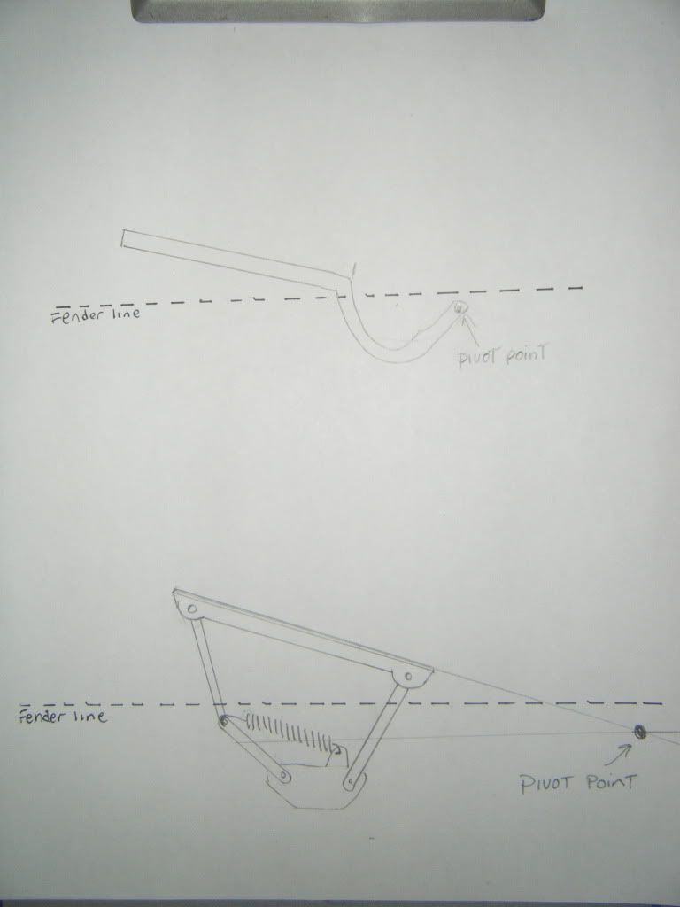

They all follow the same basic geometry in that the pivot point is moved back behind and below the hoods top surface line.
As you can see by my crude drawings I too am in the dark about the exact geometry that is at play in these old hinges but I have the basic idea. Where the exact intersection (pivot point) I don’t know but it is something like this.

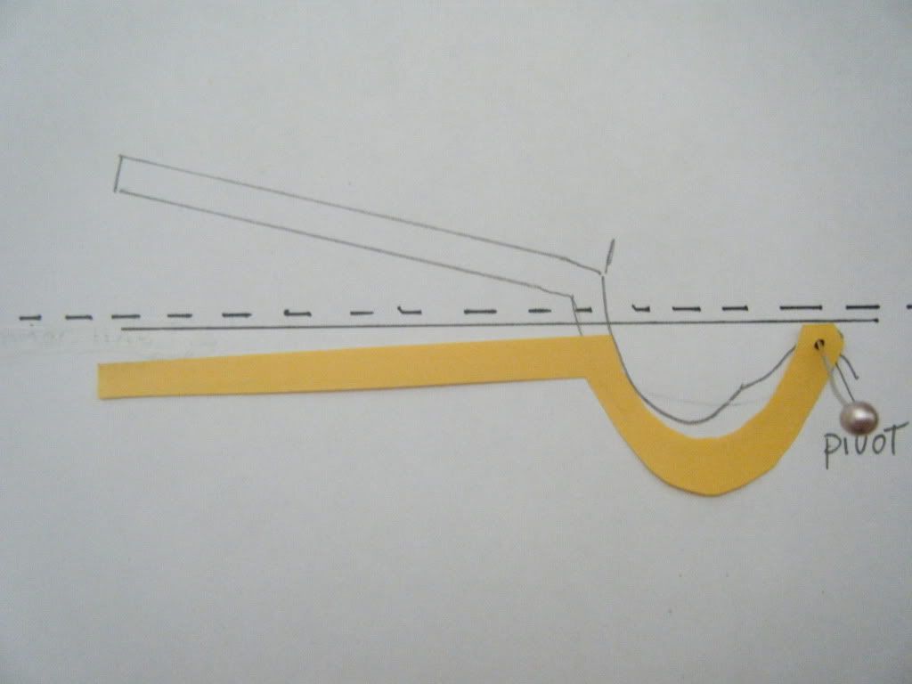

You can see by this drawing with my paper hinge how when it lowers further like if it is pushed by a shim, it lowers the rear too. You can clearly see that in this model, it IS lower at the rear.
Which results in the hood going down at the rear!
