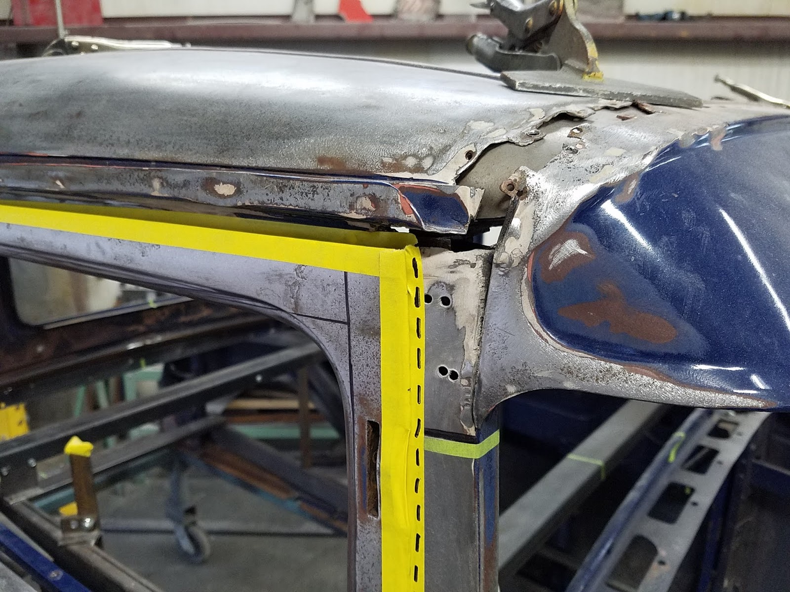

By the time I turned my attention to the A, my iron will to destroy had been bent as told above. Calmly and happily, I approached it like a kid with a boo-boo. Aw there there. Where does it hurt?
When I pulled myself off the car yesterday, my exact stopping point was when, after clamps were holding the door from falling, I turned to look for my air ratchet. I had scooped all (dang near literally) my tools aside in a shameful floor heap along with scraps, screws, parts, and all. Clear over there. To dodge the broom that didn't show.
It was go time. But I wanted real bad to loosen just one screw, at the roof / A pillar holding plate which the door was tucked under. But no time.
Would not have made a difference, in retrospect. Would have taken two more screws for me to have seen the light. Once I took that whole plate off and could overlap at that top right corner... and pushed the door up to match body lines...

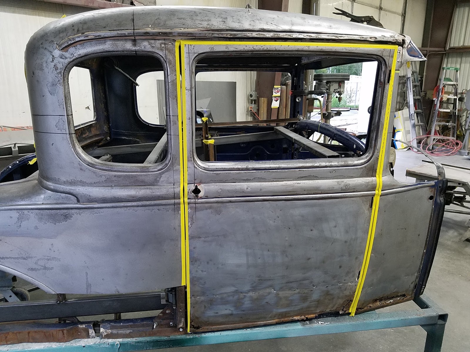

Bam. I had done right after all. Indeed, I am my own worst critic / hypochondriac / spaz / whatever. There was the right amount of space for flush fit with gaps, and excluding the top corners, the door fits fine. Sits closer to the drip rail than the other.
One step left because you're looking at a bubble here... can you see how the whole door just turns right north of belt line? Other side is square as you please. Rip was giving me some valid advice by saying watch out for that.;)
By the way I got word that we will get new pre bent drip rails thank goodness. Those may actually be causing a great deal of trouble I am encountering so I will gladly hack the olds off.
I put tape to help see. Dotted lines here help see where door edge overlaps at top right. If you look closely at this and the above images, you can see lines around the window opening. These revealed that the back of the door window opening is tilted in relation to the rest. Obviously, due to the original overlapped door configuration, door top fit was an area with tons of slop engineered in. And since the overlap covered so much evil, those portions of the panels were likely not considered critical during construction. So here we are.
Just a peek inside here. Forgot to get a pic with both doors open. Work in progress, hinges not tied, soggy bottom doors flappin in the breeze still.
