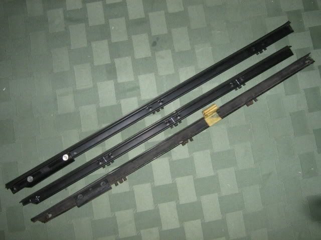

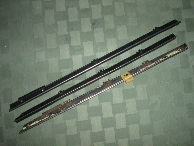

Below are just two of my “treasures” in repro parts that I am dealing with. The first is an interesting example because I have two different brands of repro part and not only are they both wrong, but they are both wrong in a different way.
After wrestling with one and drilling the plastic guide off the original and drilling new holes in the body to install it on my door I found another box of repros in my storage! DAMN IT, somehow over the years I bought two sets of these things. Anyway, when I found them I pulled one out of the box and got a sick feeling in my stomach. It looked WAY better than the one I made work. It had the plastic guide already on for example. DAMN IT. So I pulled out an original and quickly, I mean QUICKLY found that it wasn’t even close to the original and that the one I installed was MUCH closer. That made me feel good, it was the first victory I had so far in this re-assembly.
But check out the differences! One repro is a half inch too short (there is a mounting screw in that last half inch on the original for Gods sake!) and no plastic guide. The other is a half inch too long with a completely different plastic guide and clips in the wrong places! And there are only two clips where the original has three! Of course on the box it clearly said “1964-65 A body”, what a friggin joke.

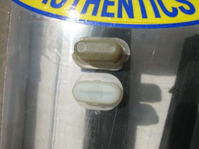

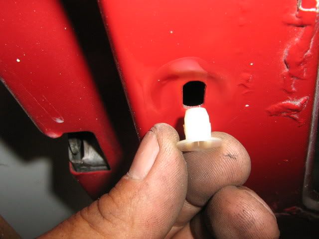

These are door panel “plugs” that go in a hole on the door and the door panel “nail” goes into them to hold the panel on. These repros are so far off they can’t even go in the hole. They wouldn't go in, WITH A HAMMER. I thought, ok, I’ll warm them up in hot water. This old trick will do magic when fitting a plastic part, making it more pliable. Nope, sorry, hot as blazes with a hammer and it wouldn’t even come close to going in the hole and in fact the door bent first! These friggin things aren’t even close! Do these companies that make this junk just guess? Does some rotten bast-ard go thru manufactures catalogs and find stuff that looks close from some other application and just re-package them as repro parts for my Buick? Where these “plugs” really made for an instrument mounting point on a Cesna 150 airplane and some doof thought they were close enough for some moron building an old Buick to use?
