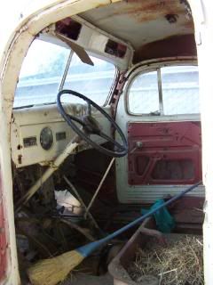

Here she is, the gem as my wife calls it, a 1946 Dodge WF32 1 1/2 ton. And it came with a title, black plates and a bunch of spiderwebs. I spotted her in a back yard/field while at a garage sale, asked the gentleman if it was for sale, $500 dollars he replied, there's not a lick of rust through so far, only a couple of small dents, I cut down a small tree that had grown between the bed and cab. Here's where it gets good, my brother in law towed me home while I drove it, 9 miles, no brakes, had to use the tranny to slow down. Our neighbor followed and laughed all the way, weeds and crap flying off, the tires were hard and she bounced anywhere over 15mph. Still, a couple of other Dodge guys went passed us, thumbs up, it was really cool, made feel like a kid with my first car. I've already started taking it apart, just want the cab and nose to make a 1/2 ton. :thumbup:

Yep Dinger, right down the street from me. Now I need a Dakota frame and a bed, keep an eye out. I spent yesterday morning grinding off bolts. Looks like about half the body mount bolts need the torch, I can't get to them with the wheel.
My nephews dog was trying to help, I'm laying under it, went feeling for the sawzall, the little ***** dragged it off.
I'm removing several parts that won't be used, like fenders, motor stuff, wipers. The inner fender panels are really cool, factory louvered.

I drove 4 hours yesterday to buy a frame and bed, all for 500, a bit pricey maybe, but I needed them...The cab is torn down and ready for a chop, 4" backside and 5" front, body drop of 4". Man, there's not a lick of cancer, how lucky is that..
