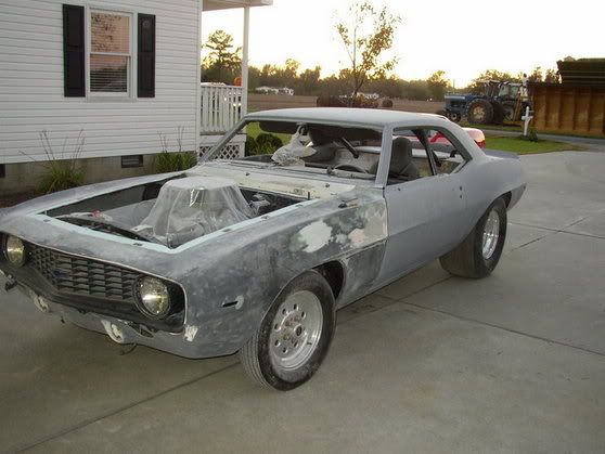

Im reworking one on my buddys 69 camaro right now. Not sure where it came from though. It was on the car when he purchased it several years ago. I do not like the flange style mounting of the hood. If harwood makes one that is the one to buy. They fit better than any other brand I have installed.
See less See more
2
Harwood makes one that uses a hood with a normal outside lip. Looks much better than the flange style mounting.
