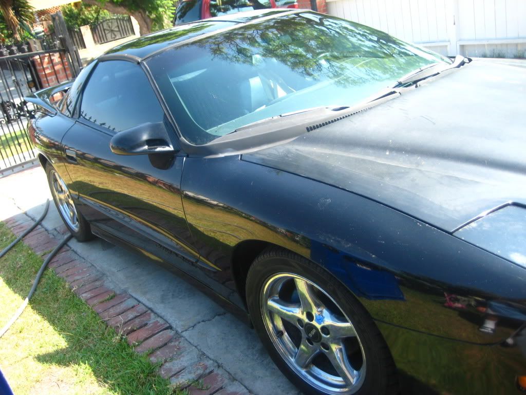

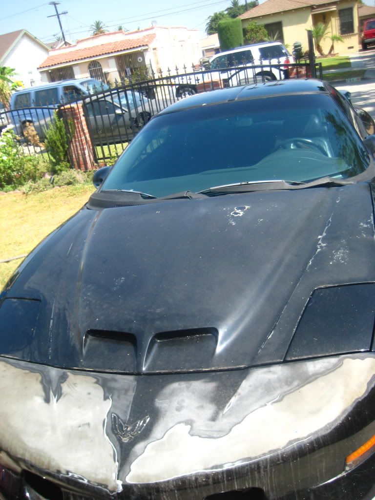

First let me introduce myself. My name is Moses and I'm from Los Angeles California. This car is a 1996 ws6 trans am and it was the first car i bought. not my first car, that was an 87 rs camaro. I was 19 and a freshman in college. unfortunately i blew a head gasket sent them out to get ported and added a cam, headers, clutch, exhaust, and some other mods. after that i had a stupid p0100 code that the dealer wanted 2000 to fix. so it sat in the sun and this is the outcome
Ok so my friend that i played high school football with fixed the code(stupid easy fix) in exchange i painted his03 r1. So far i have half a gallon of spi grey regular 2k primer, I'm going to buy a gallon of spi clear, 1 gallon of Hok bc25 per jims recommendation. I don't want to spray the jambs as they are black already i really want to do the body work, and spray it at school. other than the driver side rear panel that i messed up in a fight and the cracked paint on the bumpers the car is in great condition. on that bumper i plan on welding the holes from the old screw type puller my dad used and use the weld on puller to the remove the dent. and take the bumpers down to the plastic.
My questions are: should i buy black epoxy instead of using the grey 2k primer? should i do the jambs? Is bulldog affective for my bumpers? Is it ok to take off the bumpers, spoilers, and hood and paint them apart? Thank you guys
