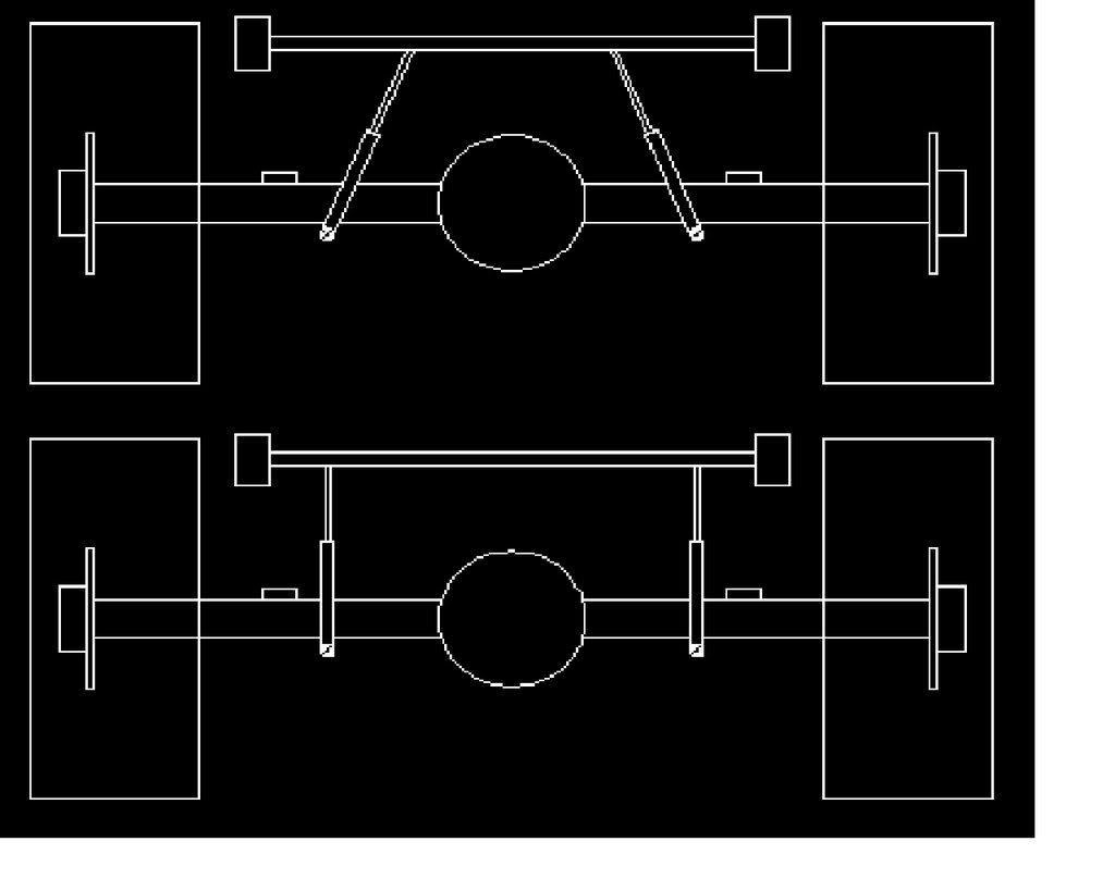

I am fabing up shock mounts for my Firebird and would like to know the answer to the above question. They are both behind the tubes and will either be verticle or rotated inward.
This is a correct representation of the set up (scale wise - quick 2d AutoCAD) :

i can't say these are pros or cons, depends on what you are looking for:
with the shocks mounted verticle the shocks will be stiffer, the shocks will also react a little better to body lean through a turn. also that tube between the frame rails will have less tendency to flex because the tops of the shocks are attached a little closer to the frame rails (of course this will be offset slightly by the shocks being a little stiffer in the verticle position)
with the shocks slanted in, the shocks will be a little softer and have a little less resistance to body roll.
there is no right or wrong, i just depends on what you are looking for. i have moved the rear shocks more to the verticle for better handleing on several cars and you CAN feel the difference. oh, and i like KONI adjustables hands down.
