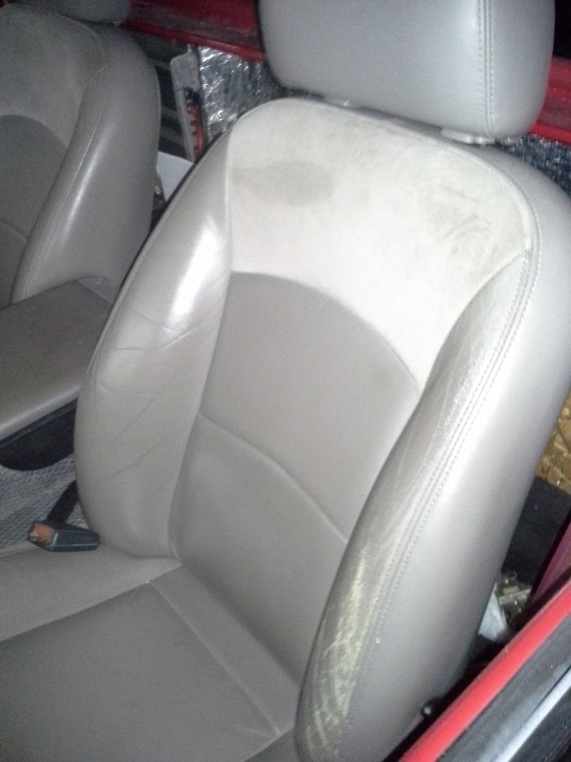

so I have mint leather seats from an 02 Chrysler sebring sedan in my 64. they are the wrong color. id like to change that.

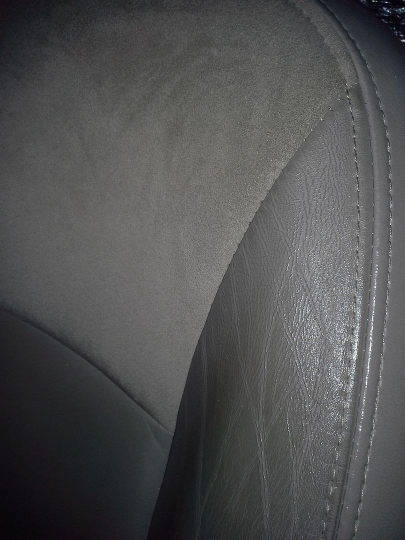

the seats appear to be leather, I should say. im pretty sure the fuzzy parts are suede. I am not certain. is there a way to be definite?
now, id like to dye them to match the rest. all the trim has been shot with SEM Portola red, and the door panels matched to that. I have used tons of SEM products on plastic/vinyl interior parts over the years, and always been pleased with the results. however, I have never done leather.
is SEM the best stuff to use? ive looked through every single page in the interior section here, and seen many references to a SEM classic coat for leather, as well as other products. im pretty sure ive been using SEM color coat. same stuff?
anything better than SEM?
heres pictures to help you guys identify just what im working with and what to do to turn it red.
#2 · (Edited)
No, SEM Color Coat is different from Classic Coat, and there is a third product called Sure Coat. SEM recommends using either Classic Coat or Sure Coat on leather, all three on vinyl, and either Color Coat or Sure Coat on rigid plastics. SEM is not a paint, it is a flexible coating which can bend with the movement of the leather or vinyl, and is actually drawn into hard plastic.
Your seats are not 100% leather, the perimeter pieces are made of matching vinyl, and the parts you sit on or lean back on are leather. The "fuzzy parts", they are probably not suede, they are probably an imitation suede. Real suede has a grain to it, and when you rub it, it changes color, but so does imitation suede. The imitation suede parts will be a problem to re-color. You can't re-color fabrics like that, only enhance the color they already are. If it was me, I'd replace the imitation/real suede parts with real leather, but that will add a lot of expense to the job. For the leather and vinyl, Use either Classic Coat, which comes in aerosols, or Sure Coat, which comes in bulk containers and requires a spray gun. Sure Coat will be cheaper for coloring a whole set of seats.
Your job will only be as good as the preparation you do before re-coloring. However you do it, use only SEM cleaners, adhesion promoters, and prep products, and follow the instructions TO THE LETTER.
