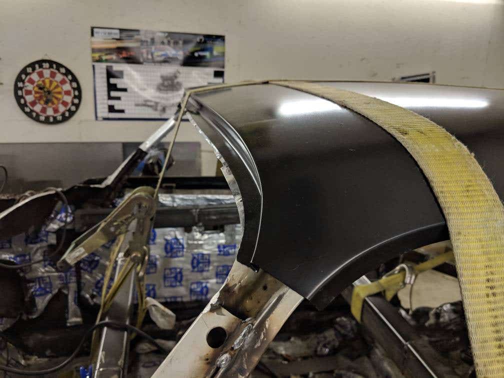

Hey guys, it's been awhile since Ive posted. Over the winter I got a new phone, rooted it, got into techy stuff and have been wasting time with home automation. Now I'm getting back into my car right when I'm not going to have any time because we'll be in the fields soon! :-( oh well, I'll work it in on the side like always. Just like everyone else.
Anyway, if you remember I purchased a whole car to cut the roof off and put it right on my car. Well I screwed the skin up, so I had to buy a new dynacorn unit. I'm still not ready to say it's a bad piece. It is THICKER than stock by several thousandandths and measures spot on to the original (with a tape measure), but I MAY have a couple issues. It seems like it may be a bit short. Some internet searches for "dynacorn roof skin replacement on 2nd gen fbody" will promptly return results of people having similar problems when doing this same project.
I've started locating the roof skin off the stock quarter panels. I'm working forward in a sense. It seems the front may be short by 4-7mm depending on where I measure (.146"-.276"). See pics. I measure off spot weld centers in the donor car skin to the inside edge of the donor roof skin window flange right where it 90°s up to the skin roof surface. I then compare this by locating the tip of my steel rule in the new skin 90° and then measuring to the center of the correspondening spot weld on the inner roof structure. Its an approximation, but I think it's telling. The inner roof structure is welded to the car. I did this measurement for one weld on the PS and one on the DS. DS (2 spot eelds right near each other) was ~7mm and the PS (3 spot eelds right near each other) was ~4mm.
I will NOT be installing the factory window trim on the finished car. I want a flush glass-look. I'm not actually buying flush glass and will just be installing some of that push-in foam/rubber glass perimeter beading around the windows like on the 4th gens and most modern cars. I've seen this on a couple cars at good guys and you'd never know the difference. It looks great and is a fraction of the price of these flush-mount front and rear windows. Even on close inspection it looks like a pricey flush-mount install.
That being said, IF I am off too far, won't the push in seal give me some room for error? If the channel between the front edge of the roof skin and top edge of the windhshield is too wide I think I could get buy by welding in a filler rod contoured to the skin to narrow the gap. Then I'd just push the rubber channel in and its flanges would go onto the windshield a bit and a bit onto the roof skin as they should, and you'd never know the channel was actually a little too wide.
As with all things, I know this is probably easier said than done. I'm probably missing something. Please take a look at the pics and tell me what you think. The side to side ratchet straps definitely help the positioning. The skin was WAY further back before putting them on- maybe by like 3/8". I MAY be able to crank them down a click or two more without worrying about popping the roof skin in. The ratchet strap that runs the length of the car in the center isn't really cranked down or doing anything. When I tried to crank that one the roof structure just bowed and if any of the straps were gonna cause damage it was gonna be that one.
How should I proceed?

Welcome to the world of aftermarket panels.. What i would do is temporarily set the windows in place at this point to see how they fit. That will tell the tale. Then you will see how much to adjust and where..
You may need to do a bit of slicing and dicing to get to where you want to be.

So do you think it looks way off? I can't make em my mind. I figured I'll have to put the windows in. I'll have to tack some panels on to make that happen. The cowl is currently off. I'll get er done though!

Glad to see a new skin. Put the ratchet straps away please. I would like to see how it fits without them. It does not look terrible but glass should be fit before you weld.
What you are dealing with are the bends. The angles may not be perfect and that is not unusual even with OE parts.
In your situation, I proceed thusly:
Clamp the front where it fits best, look at the back. Remove clamps. Clamp at rear where it fits best, look at the front. One of these ways will be better than the other usually.
Clamp the worst fitting end as close as you can get it (ignoring other end), then drill 1/8" holes through both layers out near the corners. Unclamp that, reposition, and clamp the good end. Go back to the poor fitting end and use an awl through the holes to align them best you can then clamp or run screws. With it thoroughly clamped or screwed this way, now you can gently persuade the edges of the roof to relax in this position. The new panel should lay right in place with little gap left to clamp when welding. Warpage occurs when welding metal under tension, so you want as little force needed as possible to hold it in place after final fitting.

Yup, I noticed the skin was clamped perfect on one end, resulting in a 1/4" gap at the other. By moving the skin 1/8th" you effectively divide the shortage and end up with 1/8" on both ends. Perfectly normal for a repro and, most likely, an original as well. By doing what IDJ suggested, you can cut the shortage by another 1/16" on each end.
#15 · (Edited)
Exactly..:thumbup: Spilt the difference, I used to say that every day when guys complained they cant get a good gap. if you split the difference and its still not acceptable then you take it to the next level. Usually that just means getting a bigger hammer. then comes the port a power etc..
On the front, the angle is off about a 1/4". all you need to do is bend it forward a bit if you hold a piece of the original next to it you'll see what I mean. It a simple fix to tweek it forward I have a big pair of channel lock pliers that I use for doing this you just bend it forward a little at a time until they line up.
Its hard to explain without showing you and being right there but I'll try: The Lets say old skins lip is a 90 degree angle and the new skins lip is about 75 degrees, bending it forward until its a 90 is whats needed. Now, the exact angles degree is not important I just used those numbers to explain. but just bend it until the edges line up and screw it down. then get your old trim pieces and and install them to see how they fit. THATS the important part. in reality what your worried about isnt even that important so dont sweat it and dont ruin the skin trying to get those edges to line up with a micrometer. because in reality you can weld it in as is and never know once the trim is on. screw it down like it is then install the clips and moldings or just tape the moldings on and see if Im wrong. No Sweat.

Thats actually a very nice trial fit to be honest, and better than I expected. I'd be pretty happy with that piece, as long as you inspect it close for handling damage or an uneven crown.

So, the first batch of pics in the OP we're aligned from the back. That created the big discrepancy between inner roof structure flange and roof skin flange on the front that I was fighting.
I took the ratchet straps off and now aligned it at the front. It looks much better. What's strange (in s good way) is it now seems the back aligns better than when I first put the skin on the car. Could the straps pulling on the skin for a week have moved things some? I sure wouldn't think so, but something looks better. Here's some pics.
I'll see what you guys think, but it looks obvious to me that aligning off the front flange looks better. The back flange is where I will drill holes and use the awl or screw driver in drilled holes to pry the ~85° step-down from roof skin to roof-skin-flange to a straight 90° as prescribed by IDJ and DBM- thus pulling the metal out and getting a better alignment with my quarter panel edge.
As you can see from the pics, the rear edge of the quarter on the DS is about 1/4" back further than the rear edge of the roof panel. It's maybe 1-8"-3/16" further back on the PS, so I'll also have to do some difference splitting I think!

O yeah. That looks like you could just about undo a few clamps and correct that with your bare hands. Bend the step first, then clamp the outer skin flange back flat all the way across. Not a biggie. Nice roof skin and as we have said, don't sweat lining the edges up perfect because as you see the trimming is very approximate. Average that out and its probably good. Fit everything else you can though, too. Before welding.

I'm trying to follow all of your advice to a "T." I may have forgotten about the part about screwing the whole car together because of the long break I took between the full rocker fitment and welding. The stock roof skin incident and then a loooooonnnng break from the car came between fitment and weld. It was not intentional. Same with the inner roof structure.
Hopefully i can get my butt motivated and there won't be more long breaks, and this will all stay fresh in my mind. I'm gonna start removing the PS door, get the PS full rocker on with screws, screw the tail end together, and then sit it down. That seems to be what everyone is suggesting.
Thanks fellas.

Hey guys. I've got the PS full rocker sheet metal screwed onto the car. It's close enough to put the door back on to see if I'm close. If it's close I'll align the door, and verify the rocker's in the right place based on how it lines up with the quarter.
After that I plan on fitting the cowl. Then I'll for the roof skin. Next I'll install the winshield, rear window, and make sure the passenger windows can be rolled up to a spot that looks normal.
I hope to have these things completed by mid-morning today. IF, and that's a big IF things look good enough to proceed at this point, where do I go? Take a look at the car and how torn down it is, and I think you'll see what I mean. Do I then set it on its wheels, fir the whole car together (front fenders, nose, hood, any trim I still use, seals, and make adjustments?
After that I think I'd move to quarter replacement. Is this the correct plan of action? I'd love some help and input to keep me going today. I'm missing good guys in Columbus today and this weekend to work on this project, so help keep me rolling to make the sacrifice worth while!! Haha. Thanks.
