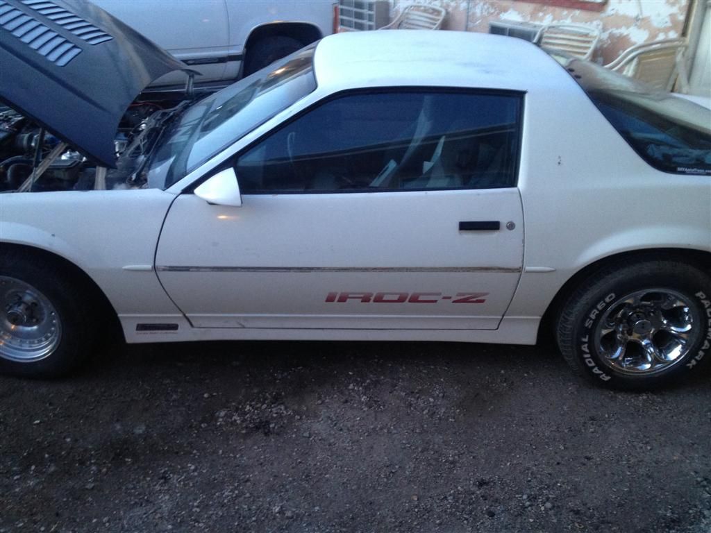

ok heres the majority of my body work i need to do
first up this is the big one the passenger side door
my first thought was hammer and dolly from the backside , but its not possible
thoughts on using bodyfiller to straighten out the panel?

and the last bigest piece of body work fix this dent in the ds rear quarter ,
luckily this one i can get to the entire backside of the panel with a hammer/dolly
as u can see the rest of the car is fairly straight and needs minor work

my buddy may actually have one of those pin spot welders, if not my uncle showed me a trick with a tig welder and special rod i can use in a pinch
the rear quarter is easy accessible with a hammer and dolly and im confident i can get that straight enough ill need minimal filler
the door is a lil rough the crease is deeper then what shows up in the picture , im sort of afriad that the metal is to streched that even pulling it its still going to need a bunch of filler . but pulling it as much as possible then using less body filler seems like a good much better idea
on a crease that long would u apply body filler as is or would u put a few small holes in the crease for the filler to grab into?
i have to try to save that door like i said earlier the doors on this car do not sag one bit any used door i get is going to have hinge pins that are worn the hell out and i dont want to deal with that

Any time you can move the metal back to or close to what it originally was...never put holes in a panel for filler to "grab onto". Filler grabs quite nicely without holes and without holes, any moisture around the repair area will not become a concern down the road. Filler is a sponge and will hold moisture long enough to cause corrosion, so if you have holes, weld them up.
Good luck Bud...please keep us informed...I love to see hard diligent work get rewarded and I'm confident you can make this Camaro stand out.

Hold on now ,first things first.....
the first thing I noticed is its white then what looks like big spots where the paint is coming off...Gm had a problem with white not sticking well so before you get started get a razor scraper and try scraping the paint off if it comes right off you may have to strip it before doing anything...
Those doors are plentiful at the Upic it yards and for about 50.00 and a bit of luck you can get one thats nearly perfect (I just bought one for my Iroc) You'll want to replace the pins and bushings in the hinges before you get going with bodywork and while the doors are off you might as well paint the door jambs and back side of the door the color your painting the car.Color change can be a PITA and a lotta work ....Then you'll want to remove and paint the backside of the hood and deck plus the jambs ...Personally I think white looks great on these cars with the semi black trimming,so think hard on it before changing the color not to mention the darker the color the more it'll show any imperfections white always hides imperfections on the other hand these cars have pretty terrible gaps which a darker color will hide and white will make them show more so theres plenty to think about. luckily for you theres plenty of thngs to do before you buy paint one more advantage to white is the cost, solid colors can be a few hundred dollars cheaper if you use a single stage paint which is also much easier to easier to paint ...

those spots u see are were the po had sanded and sprayed white spray paint on the car , i know the problem u are talking about though, my silverado in the picture next the camaro has the white peeling off , it comes off so easy i could use a razor blade to strip the whole damn truck , took me all of 5 mins to strip a portion of the hood on that thing
my friend doesnt hve experience painting a whole car but i have seen some of the collision work he has done , most notably an olds alero that he picked up and fixed, car needed a front fender/hood/front bumper and lights. the car was a gold metalic color, i think they call it champagne metalic .
