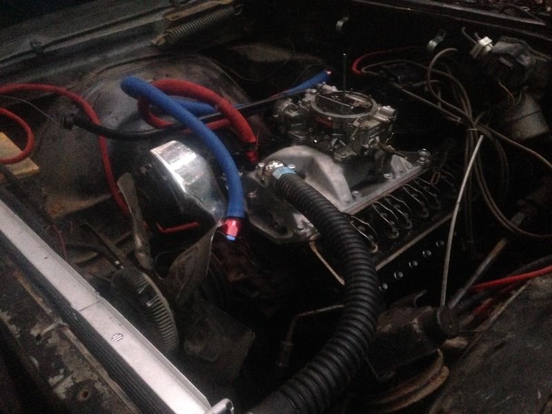

If I go carb I'll probably do a vortec swap. Just did that on my 400sbc in my 69 chevelle, 062 heads, air gap intake. Went with steel shim type gead gaskets on that, deck hight was pretty bad but got my quench around .050-.055 area.
With vortec heads, performer intake (no air gap to help with hood clearance) mild-ish cam, 650cfm carb. Stock bottom end, and would have to swap to a HEI style distributor. What kind of #'s do you think I'd be looking at?

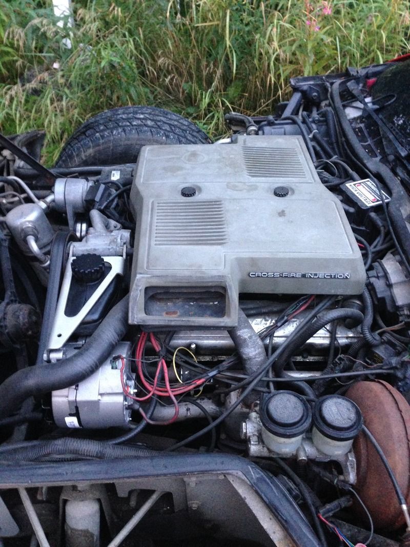

Just for fun, under hood pic on the vette. It's originally an AZ car that found it's way up to alaska.
