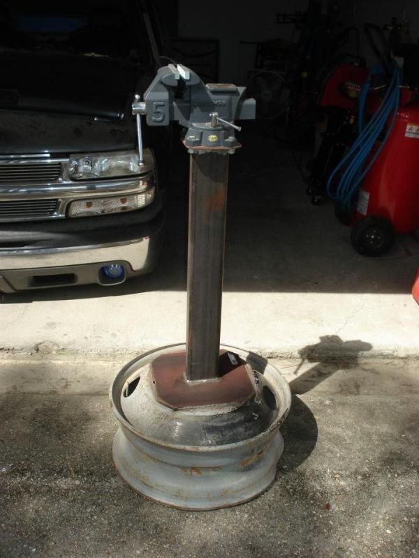

First thing I would build is a vise, mounted on a large diameter steel pipe (something like 152 mm) which is mounted to a large truck steel wheel (something like 508 mm) so it will be substantial, but can be moved around in the shop. I might be thinking this type of vise....
https://www.amazon.com/Wilton-14500.../ref=sr_1_21?s=hi&ie=UTF8&qid=1471451546&sr=1-21&keywords=bench+vise+heavy+duty
Also, buy these magnetic nylon jaw liners to protect soft metal pieces like aluminum or plastic that you might be grinding, filing or sawing on.
https://www.amazon.com/Nylon-Multip...rsible/dp/B019VOT6JG/ref=pd_sim_469_5?ie=UTF8&psc=1&refRID=M1Y6B2TYAZVPMN0E5VSP
Here is what I'm talking about....
http://img.photobucket.com/albums/v...com/albums/v93/lngbedslvy/Vise Pedestal/485434_10150670317428836_1627427668.jpg

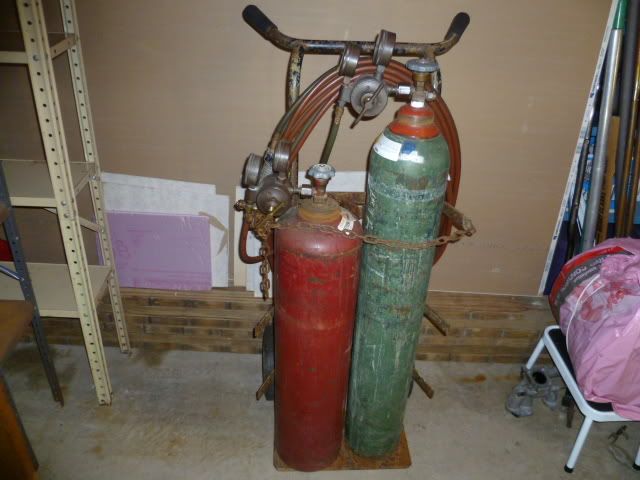

and an acetylene cutting torch rig with the largest bottles you can find.
http://i826.photobucket.com/albums/zz181/9ugc7tdz/misc/largerig1.jpg
