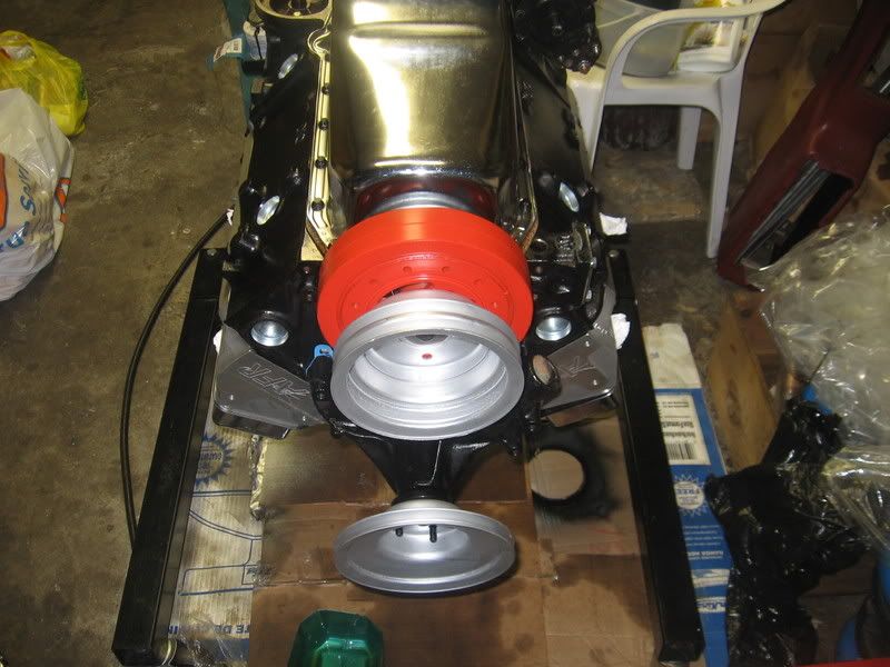

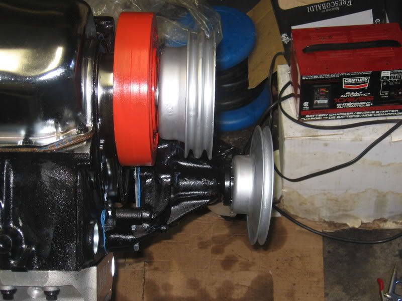

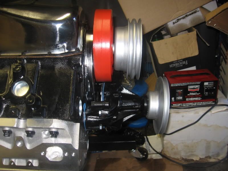

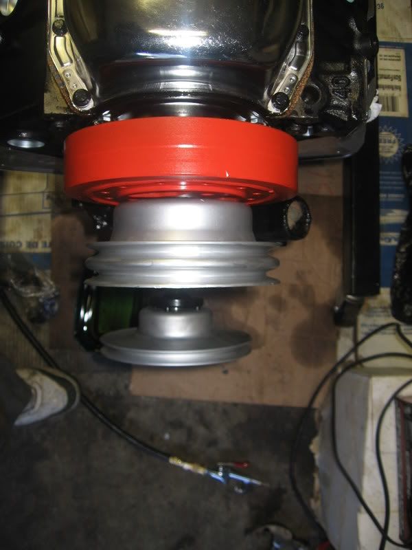

Hey guys so I just installed my harmonic balancer on my 383 stroker and now I am lining up my pulleys to make sure they align. I am using the entire pulley system, even the same water pump off of the stock 1980 350 that came out of the car. Looking at the pics you can see that I got like a 3 inch gap between the alignment of my crank pulley and my water pump pulley!! :smash: :smash: I am possibly thinking that maybe the water pump pulley is on backwards in the pic?? If I flip it around it looks a lot closer to alignment but i can't remember which way it is supposed to go!! I also can't remember what the belt routing is either becuase the crank pulley has 2 valleys and I don't know which valleys drive what. If anyone could clear this up for me it would really help because I know something is wrong, just look at the pics!! Also is that the "Long Style" water pump I have??

trun the water pump pulley around .this might help :thumbup:
I had a water pump pulley backwards once,(but it was only out by about 1/8th inch) It ate two belts before I figured out what was going on :rolleyes: So I cant say too much. But does it look like it will still be misaligned when he does turn it around....or is it just me?
Shane
#16 ·
just now saw this pic - - - the WP pulley is definitely on backwards but I think you still have issues with the drive pully and WP pulley coming from different sources and not being compatible - - - don't know if you're running a fan or not but there is no way to bolt it on with this set up - - - :confused:

Man you guys are something else.. :nono:
How can you not see that this guy got the wrong crankshaft...it's too short on one end... :eek: .
Doesn't anyone see how easy this problem could be fixed and still use the short snout crankshaft, (which are better anyway...less twist)
A quick trip to the lathe to make a 3" thick lower pulley spacer would fix this right up...
Man I need to be everywhere, don't I...
BTW, I'm thinking about adding this discussion to the knowledge base, so it will be helpful to all :thumbup:
Lemme know.
Later, mikey
