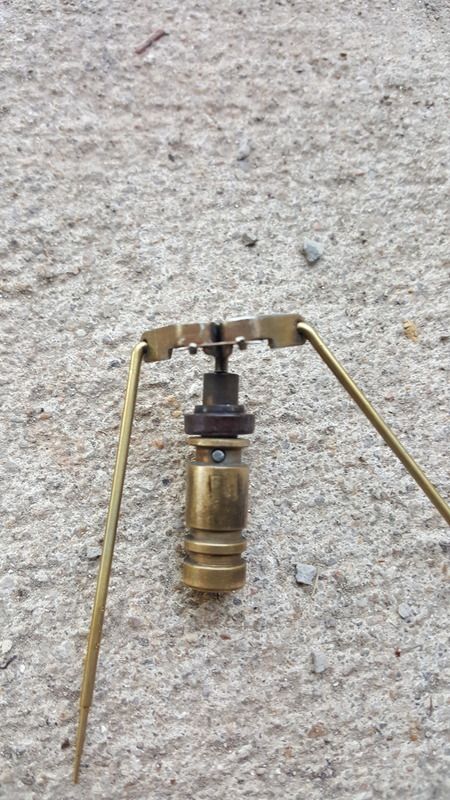

yes.. carb number please..
at what engine speed is it 10 to 1. at idle... slightly above idle to 1200 or
1300 RPMs.. 1400 to 3000... before the secondaries throttle plates start to open in the base..
at idle.. the system is running on the idle circuit ONLY not on the primary main circuit so jet changes do nothing. to any engine speed below 1200 or 1300 rpm this is all dependent on engine displacement.
mid primary throttle .. note that the primary rod holder is still seated on the APT adjusting screw.. this is cruising speed..
when you tip into the throttle.. the primary rod holder will come up off its stop as the manifold vacuum drops.. enriching the primary main circuits..
if the primary rod holder is adjusted too far down.. you will have a lean or a rich off idle as the vacuum pulling the rod holder down against the stop will either be too far up or too far down. this is why i ask about what speed you are having 10 to 1 on your wide band ..
this is wide open throttle with the primaries and the secondaries open and the engine speed enough to pull the secondary air doors wide open. note the primary rod holder is all the way up.. enriching the primary circuit..
are you sure you got the proper gaskets installed there are several very easy to put the Wrong ones in..
you could also have slightly too much float level.. you could have leaking plugs in the bottom of the main body.. in either the primary wells or the secondary wells.
if your idle speed is set too fast.. you could be exposing too much of the idle transition slots. you may have this because of your cam... or a vacuum leak. you could also have a lack of designed in vacuum leaks. or bypass air.. wrong PCV valve.. out of place throttle blades.. they do get banged off center when the carb is off. i usually have to spend 5 or 8 minutes when i have a qjet apart just on adjusting the throttle blades to recenter them.
edit... i would take the carb off.. take out the long 2 screws from back of the top cover.. flip it over and take off the 2 or 3 base plate screws.. you can flip the base plate around to unhook the throttle rod easily... spend 10 minutes recentering the throttle blades.. do not loosen the screws more than 1/4 turn they will break off.. check the throttle shafts for play also..

#14 ·
after you get the steady throttle air fuel ratios in...
perhaps just going back to close to the stock jetting..
do you have the APT plug out of the top of the carb.. you only need to reinstall the plug or put in a 1/8 pipe plug to return to normal service so you don't splash fuel out of the carb top..
you can use one of the larger valve core tools for farm tractor and off road equipment tires to do the adjustment..
you will also want to create a Dipstick out of plastic.. Zero of the 1/32 scale starts 39mm from the tip..
you will want to find the minimum spot where while you are pushing down lightly on the dipstick that the APT screw starts lifting the primary rod holder. you may want to start the additional adjustments about 1.5 turns up from just touching..
have you ever seen a drag racer after the burn out blip the throttle and do a part throttle take off that only moves the car 6 or 8 feet.. this is what you are going to do many times...
keep turning it upward 1/4 turn at a time.. back up.. drop it in drive and blip the throttle.. you will find that it will backfire and spit up thru the carb.. that is expected.. back up.. give it another 1/4 turn up.. blip the throttle again... still spits.. back up give it another 1/4 turn up.
what is happening is the manifold vacuum pulls the primary metering rod holder down.. if the APT screw is too far down.. as the carb moves thru the idle transition/low speed circuit and the primary circuit starts to flow.. too low a setting leans out the air fuel ratio and causes it to spit and backfire thru the carb..
keep doing this 1/4 turn at a time..you only need 40 feet of room to do this..
you will be totally amazed when you get it right. you will get to the spot where it does not improve... you may want to lower that a 1/4 turn.. you can fine tune the APT adjustment at 2200 RPMS steady throttle on a level road.
this can make or break your love affair with the quadrajet.

#17 ·
do you have compressed air. and an air pressure regulator on the line so you can turn the pressure down to about 2 to 4 PSI. . even a fish tank pump will do this..
take the carb off... take the carb apart.. find the main well plugs in the bottom of the main body... spray some bubble soap or just dish soap on them.. blow air up into the main wells.. see if you get bubbles .. you should not.
tiny leaks have plagued quadrajets and others.. the entire bottom of the main body on some is exposed to manifold vacuum. these leaks will not be a vacuum leak.. they will be UNCOMMANDED FUEL directly into the intake..
please verify by placing the main body to base gasket on both sides to verify it covers everything .. this is just a verification..
please with the base plate off.. hold it up to the light.. make sure that your throttle blades are properly centered.. not hanging open. i am hoping you are aware that you can loosen the throttle blade screws 1/4 to 1/2 turn but not more without breaking them off in the throttle shaft.
this might take you 5 or 10 minutes.. just keep playing with it.. it gets easier and you will realize what an improvement it makes.
by the way... open the primary throttle slightly.. wiggle the throttle shaft with the blades off their seats.. you should not have much if any movement ( O) or (O ).. it should be tight.. (O).. worn throttle shaft bores are an issue. as the throttle blades will never come back to the exact same position.
remember... the idle mixture is controlled by the IDLE MIXTURE SCREWS.. unless you have the idle speed up high enough to over expose the idle transition slots.. then depending on the heat built up in the carb.. will make micro variations to the throttle position.
please also verify that your throttle cable or linkage is NOT holding the throttle open part way.. there must be a little slack..
these are all issues i have run into..
when you get it all back together..
AF at idle.. at what idle speed..
AF at 1200 RPMs STEADY THROTTLE after 15 seconds at that fixed speed..
AF at 2000 RPMs.. steady throttle after 15 seconds at that fixed speed..
AF at 2500 RPMS.. steady throttle after 15 seconds at that fixed speed..
Get the primary jetting done first.. secondary tuning is tricky on quadrajets.. there are many sizes of motors that you might want to use that secondary metering rod.. and try various hangers.. various secondary air door spring tensions to allow the secondary to come in earlier or later..
there are some things that happen with the secondary... and it requires load on the engine to get any results in the secondary..
have you a APT screw like in some of the images i posted..

When you "lightly press on the gas" what is your manifold vacuum?
It sounds to me like your power valve is opening and making the mixture rich.
Checking the air/fuel ratio in neutral won't give you proper readings because the engine isn't under load. The carburetor will stay in the idle and idle transfer circuits in neutral past 3000 rpm without a load.
#27 ·
I know at idle I have about 15" of vacuum. I haven't checked what it is with a little throttle, but I can.
So are you saying I have a bad power piston? If so, what one would you recommend? I'm still using the stock power piston.
#29 ·
Ok I just figured out something else interesting. I noticed when I took out my power piston, it was slightly bent (see picture below). I bent it back to shape and put the carb top back on and screwed it down as normal, and then took it off again to check, and the power piston was bent again?! Anyone seen this before?
#30 ·
the piston has a little plastic ring around it just above the largest section.. that is supposed to latch the entire assembly down after you have aligned the needles in their holes.. always a pain..
if something in the main jet is blocking the back side of the hole.. you could have an issue.. usually the rod holder tries to jump up and let the metering rods out of the jets then it bends the rod holder.
there is a chance there is an issue with the top of the carb also. more pictures... will the metering rod holder fully drop with the metering rods in the holes with the gasket and plastic insert removed..
