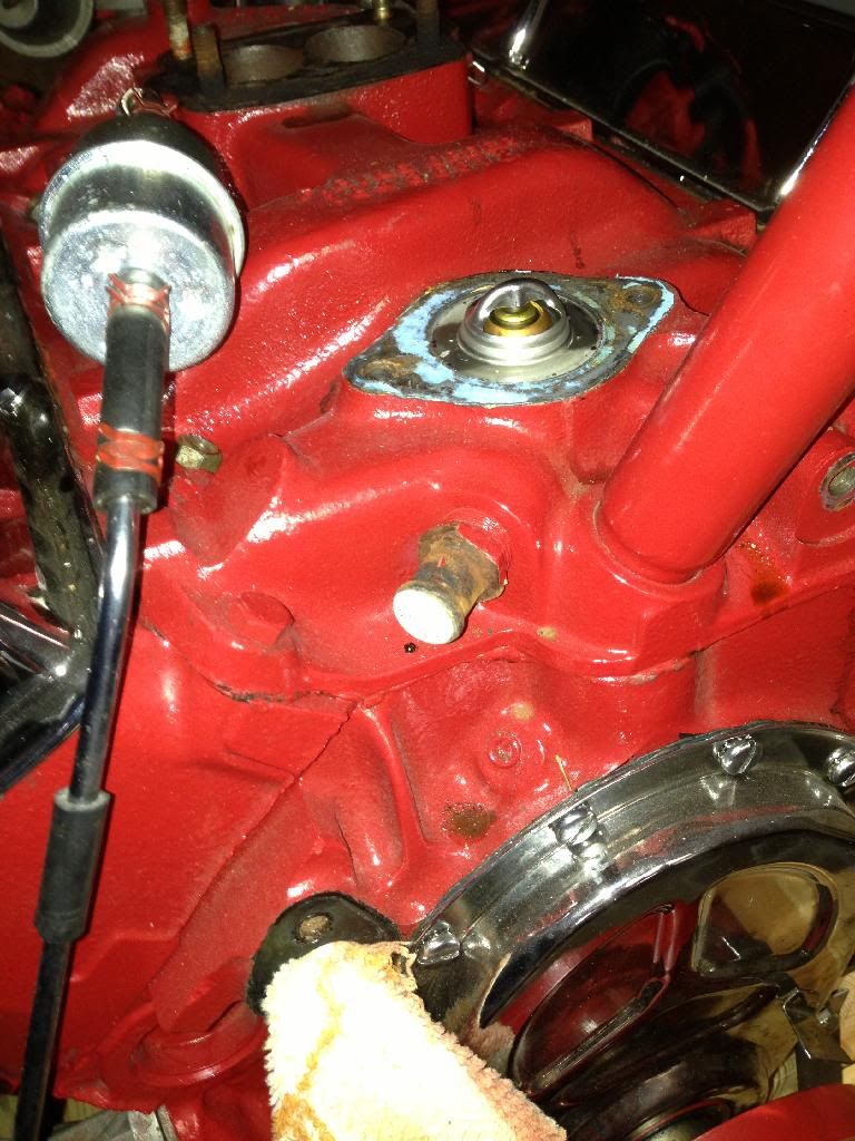

So on my old engine that I took out,there was no heater core either,just a radiator and water pump. But there was a hose that comes off the water pump and goes into the manifold near the thermostat but it didnt go anywhere,just into the block,can be seen here....
Now is this like a bypass,or was this meant for a heater core? But like I said it never had a heater core and just a short hose was ran right from the water pump to that barbed fitting just below the thermostat.
Im just wondering on if that is needed or not on my new engine? I have two ports but the one is on top. seen here....
So if anyone could give me any advice on how to run this,you can see that short hose I was talking about,Im not sure if I should plug it in like it was on the old engine or not,,,If I do need to,looks like I will need a angled barbed adapter,what are these fittings called?

The looped hose, from water pump to intake, can be removed and plugged at the pump, all it did is send water out from the manifold to the heater originally, and back from the heater to the pump inlet.
You can just plug the under carb water passage if you want, it is there for cold climate carb warming.
The looped hose is the thermostat bypass that provides circulation through the pump and cooling jackets when the thermostat is closed. A lot of guys plug these and depend on the 1/4 inch hole from the passenger side head into the block and back to the pump to provide that function. I'm not a fan and do not do it on my builds. Leaving this routing out increases pressure inside the cooling jackets as the pump holds a head against the lack of retuning coolant this risks local overheating with little circulation and risks cavitating the pump as it is attempting to deliver more coolant than it is receiving, so this lower the pressure around the impeller which gasifies the coolant especially if any water is present in the coolant, this puts bubbles into the circulation; 100 percent glycol is much more resistant to this event but unless you really understand thermodynamics it's something I can't recommend unless you belly up to the cost of Evans' coolant system.

Ok,sounds like I can go either way,but using it is probably safer. So I guess I'll just look for a fitting and go ahead and just hook the hose up.
Im guessing I will need a 90 degree elbow so its just not going strait in the air.
What are these fittings called so I can have a easier way of finding them.

Most Chevies that I've seen use the hole that is about 3 " to the right of your thermostat location on the manifold for the temp. sensor.(2nd pic)
If you try to use a 90 degree fitting in your manifold for the bypass hose, there is a good chance that it will not align the way you want it and not leak from being too loose. If you try to tighten it to stop the leak, it will be pointed in the wrong direction.
One alternative is to use the adapters/fittings in the links below. You can tighten the hose fitting pointing in the direction you want.
I'm pretty sure the hole in the manifold for the heater/bypass port is a 1/2" NPT(pipe thread).
Same goes for the hole in the water pump.
I can't tell what size your hose is. I've made a link to a 90 degree hose fitting for a 1/2" hose(-10 AN). If your hose is 5/8"(-12 AN), or 3/4"(-14 AN) use that size for the hose barb end, and do another search at Summit.
