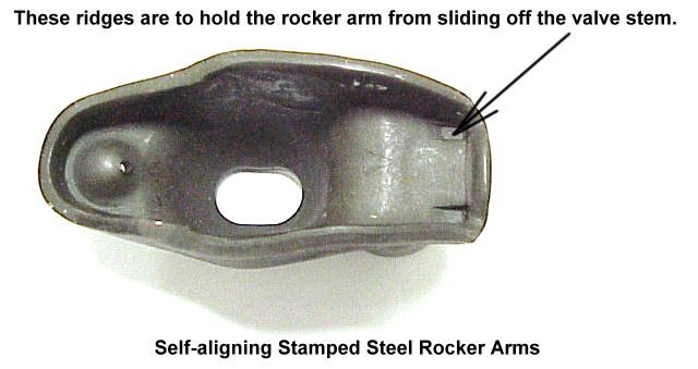

If you look at the underside of the rocker arm at the arear that sets above the valvestem, there should be 2 raised areas that ride on either side of teh valvestem thus keeping the rocker arm centered on the valve.
Here is a self-aligning rocker arm, if your rocker arms dont look like this, you need to get a set of them.

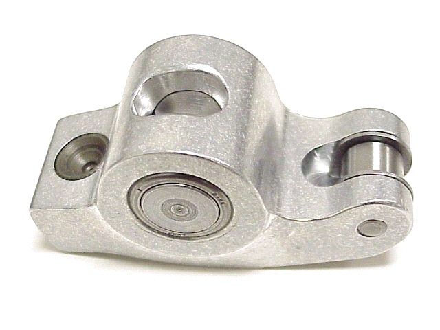

Here is a self-alining roller rocker arm, it uses 2 vertcal washers to self-align the rocker arm
