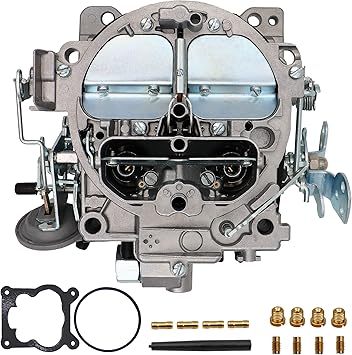

I'm a hardcore Qjet fanboi. No carb, factory or aftermarket, is more accurately metering than a Qjet. Tuned right, they're my absolute go-to for street. Incredible throttle response, better MPG, great carbs.
I also gasp disagree with Bogie. You can't throw a rock in a junkyard without hitting 200 perfectly viable Qjets for $25-50 each. They are everywhere. They were used from 1965 up until 1990 on everything from a 3.8L V6 up to an 8.2L Caddy 500 and everything in between. Carbs are chunks of aluminum with parts in them. They don't just suddenly become bad because they're old. If you're worried about tuning it, send it to Jet Performance with your engine specs. They'll tumble clean it, set it up, and send you a like-new Qjet that is an actual bolt-on. I have never had to adjust anything other than idle speed and maybe 1/8 turn on the idle mix screws. For the price of buying a brand new carb that will likely need a bunch of tuning, you get a custom-built carb for your application.
But I'm guessing your intake is a squarebore. AVS is likely your huckleberry

I'm also a big fan of the Quadrajet. They work well and that carburetor and I were both born in Rochester, New York. Always thought the Quadrajet had it's own sound at full throttle. To me, that howling sound was one of the first things that attracted me to the lifelong hobby of Hot Rodding. A Cliff Ruggles book and a rebuild kit kicked off quite a bit in my journey.

I'm not sure it's worth changing the plan. Any of the common carbs will be fine, I just like to preach the gospel of the great Qjet of Rochester. [*bows gently to the north.*]
