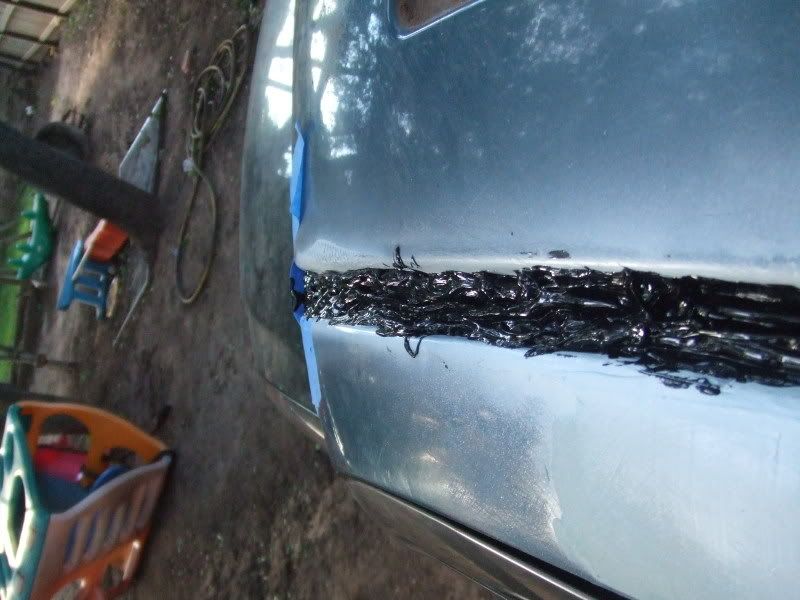

Well I hate to say this but I've reading and figuring out how I was going to apply this "83037" Seam sealer and some how at the jobber the other day talked myself into the 83038. Well I applied it today to my "Roof Ditch" and it came out something ugly with not self leveling at all. So I'm about to put up a post to see what your thoughts were and BOINK it came to me I needed the 8307 not the 8308. So now I have a roof ditch full of lumpy sealer I have to remove and re-do. Nuts I was so close. Now I have to remove this stuff any thoughts on its removal?

You should have posted asking before using it. YEOW! You have made yourself a mess.
When using seam sealer you need to mask it off, just like painting. Run a strip of masking tape down the line and you can brush it out, then remove the masking tape BEFORE it drys and there you have it, just like factory.
#4 ·
No way you could even come close doing those ditches on the F150 with the heavy bodied. Dont get me wrong in 9 out of 10 times I pick up the heavy over the leveling, but not in this case.
One tip on the self leveling. Keep the tip moving and keep it in the "pool" of sealer. If you dont keep it in the pool it can air bubble.
Also try to make sure that your truck is on a fairly level surface. 3M did change their formula somewhat on the leveling. If you didnt have it completely level that stuff would just run and run til it cured. Just dam off the front and back and tape off the sides so you get a nice clean edge.
If I recall right you have a 4door f150, you'll need two tubes, three depanding on how thick you go...Eric

On the self leveling when you work it what do you work it out with. One thing on the heav body one, you could not work that stuff. I mean I tried and it seemed like it was curring in a matter of seconds. When using the 8307 do you brush it? Also do you start the tip in the middle of the roof ditch and just let if even out then after you have one full tube used go back and put another tube down for the deired height? thanks. Also the ditch really pretty and cleaned now. roloced it then 2k primed it again...

I would wait til its cooled down seeing that you are from Texas, thats why the heavy was setting up so fast.
You wont need to tool or brush the leveling. I prefer to work from the end to end. Start in the back and work to front.
As long as you have the ditch taped off on the sides and dammed on the front just pump the seem you can get the height right. Dont go crazy with the stuff because it will run and level out.
No need to reapply.
Eeeew Now I remember somthing.
I let the car sit out in the sun due to heavy rain the night before and the let it sit in the garage for about 30 minutes. I remember at one point when I was applying this stuff I looked down the channel and I could see smoke. Cool. Oh well lesson learned. I did get the 8307 today and I'm going to put in on in the back yard where I have better air flow and out of the sun. hey MARTINSR, keep that photo and you could use it as an instructional as what not do on the seam..... :nono:
