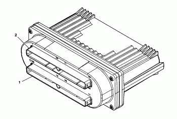

Hogg, what are your thoughts on the computer swap.The donor van is the 2002 5.7 Vortec. His vehicle is a 2003 & most likely will have alot more outside of engine mgmt.It's very possible, but, he would need to verify service #'s on the controller to check compatibility, that they would be even maybe the same controller. I'm thinking his best bet would be to simply have 5.7 tune flashed into the 2003 & work from there on tuning for cam & other upgrades vs trying to make the 2002 controller work, which would likely have alot the functions, inputs,& outputs of his vehicle. The van would not be as well equipped as the swap vehicle.
2003 is a weirdo year PCMwise. It was the advent of the 1 meg PCM, yet some of the Vettes still use the 512meg 0411 PCM.
There is a good chance that the PCM still might be an o411 PCM and might take the 0411 calibration because the 4.3's are still in use and the difference between the 4.3(3x reluctor) and the 5.7 L31(4x reluctor) is minor.
But you are correct about the differences outside of the engine calibrations. I do know that on some of the Corvette calibrations that certain functions are VIN locked, meaning that if you enter a VIN with a W instead of a Q (examples only-zero meanings in real life) that your power windows or some other function wont work.
I do know that there are 2003-2008 L31 calibrations for 1 meg PCMs that were used in Mexican GMT-800 trucks equipped with the L31. In US and Canada you couldn't get an L31 in the 99-2007 GMT-800 trucks but in Mexico you could.
peace
Hog
Discussion starter · #46 ·
Pcm
I was told that my computer would work with the 2002 5.7L I guess GM put the newer computer in the 2002 chevy express which is the doner vehicle. My 2003 astro has a lot of options such as power windows, overhead console, rear a/c. I was told by harris performance he could tune my computer to run the 5.7L. I have not pulled the numbers off the computers as of yet. I do have the donor vehicle computer also.
I really think that would be the best way to go.
Here are some O/S Identification numbers listed for 2002 F-body and 2003 Corvette
All 02-03 dual 80 pin connectored/512kb PCMs have 8 Segment Files
Security Algorithms=40
All 02-03 dual 80 pin connectored/512kb PCMs have Read Algorithms=1 and Write Algorithms=2

Some of this info might be useful in order to compare PCM and Operating System(O/S) identifications. The vehicle and year breaks are the basis structure for Tunercats OBD2 tuning software. You pay $79.99 for what is called a Vehicle Definition File (VDF) and because Tunercats uses an unlimited licensing schedule, each VDF you purchase allows you to tune unlimited numbers of vehicles/PCMs within that schedule.
Lets say I bought a VDF for 1996-1997 trucks, the VDF is OBD2_07 and once I install it into whatever computer I am using Tunercat OBD2 to tune with, I could literally recalibrate every single 1996 and 1997 truck that GM ever assembled, so long as it had the Vortec 4.3-L35, Vortec 5.0-L30, Vortec 5.7-L31 or Vortec 7.4-L29 engine. You can even get a VDF from Westers Garage in Canada wich Mr Wester has built in order to recalibrate the 6.5 liter Turbo Diesel(either the LD version RPO=L56-8th digit of your VIN will read "S" while the HD version of the 6.5TD will have the 8th VIN digit reading as "F" for RPO L65 when using TC2.
There is even a VDF for the 1998-2001 Vortec 454 with RPO L21, which uses CNP (Coil Near Plug) ignition and ETC (Electronic Throttle Control), BOTH of which were "firsts" on ANY Chevrolet Big Block engine of any Mark or Generation. The GEN VI(Generation 6) BBC(Big Block Chevrolet) installed in the 1996-2000 GMT-400 "style" trucks was rated at 290hp@4000 rpm/410lb/ft torque@3200 rpm used a 4x reluctor wheel which rode on the crank snout, just behind the damper. The CranKshaft Position Sensor, which is positioned by the front timing cover, delivered its data signals to the Blackbox PCM and along with the 1x signal coming from the base of the Vortec distributer, allowed the Vortec L29 to fire in a true Sequential fueling strategy. The 257kb "BlackBox PCM with its QUAD, 30+ pin connectors, knew the exact position of each cylinder, and because of this, was able to accurately deliver fuel just as the cylinder events were ready to accept fuel. Gone were the days of blindly spraying fuel into the plenum of an intake manifold such as was done with GM's TBI system, which was a "Wet" system as the runners actually flowed fuel and air. The 1985-1992 TPI system, was an improvement so far as the intake manifold and its associated runners carried only air, therefore was a true "dry" system, it still di not know which cylinders were ready to accept fuel on not. The TPI system as available in both Speed Density 90-92 and Mass Air Flow(MAF) from 85-89. Even the early GEN II SBC LT1's in the F and Y bodies were not Sequentially fueled, they were Speed Density MPFI, for MY 1994 all the GEN II LT1 350's and L99 265 V8s were Sequentially Fuel Injected.

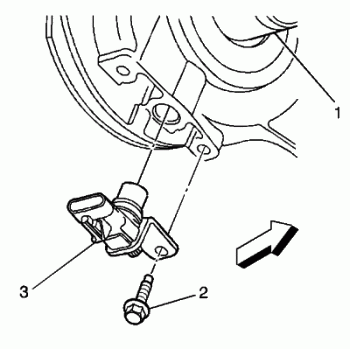

One of the "special" parts of the L21/LP4 is that tucked away behind that crank damper is 24x reluctor (aka high resolution) ring. It just so happens that the newer dual 80 pin connectored PCM's from the LS1 ALSO use a 24x reluctor wheel. Remember that both the LS1 from the Corvettes and the L21 BBC use ETC as well as CNP. If you wish to use CNP with a cable throttle, that's also covered, simply use a 1998-02 Camaro calibration.
That special 24x reluctor uses GM p/n 12552480 and costs about $28
https://www.summitracing.com/int/se...ortBy=BestKeywordMatch&SortOrder=Ascending&keyword=12552480 &retaillocation=int
the special crank sensor that is required to read this reluctor uses p/n 10456248 and costs $127 from Summit
https://www.summitracing.com/int/parts/ado-213-348
I'm seeing that the prices of these have increased quite a bit, yikes. Now if you wanted to run a Vortec 350 SBC with CNP and/or ETC, you would need a way to fit that 24x reluctor wheel onto your smaller diameter SBC crank snout.
That CKP sensor is $127 and you MUST use it to read that L21 BBC wheel, its a double wheel, so the double sensor must be used. However, EFI Connections has made a 24x reluctor wheel, that is a single wheel, that fits on a conventional SBC crank snout. Seeing as its a single wheel, you can also run the less expensive single CKP sensor, the same sensor that's found on the 1996-2003 L31 350.
