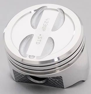

or do they have only 2 valve reliefs like this....
