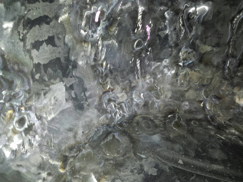

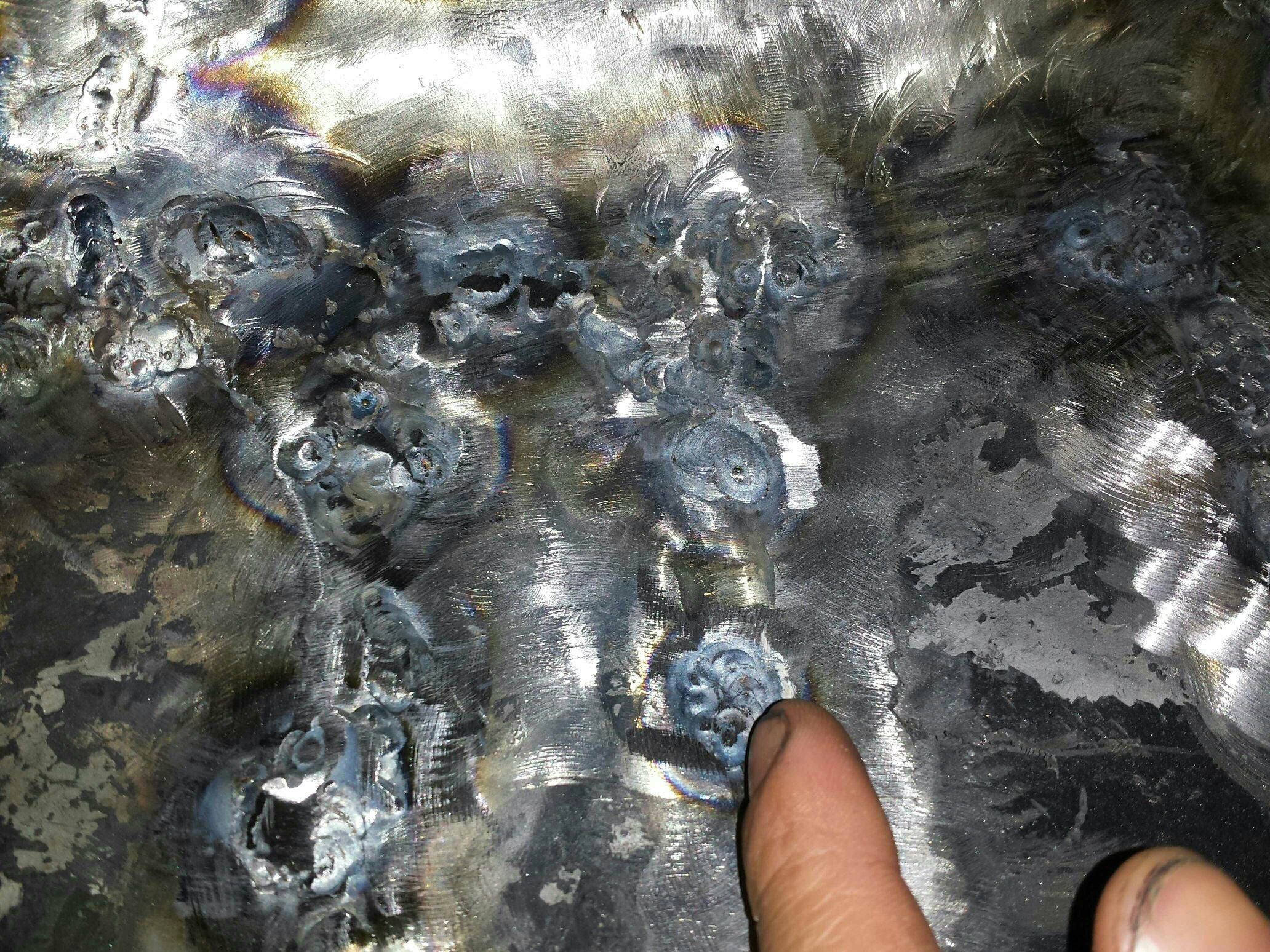

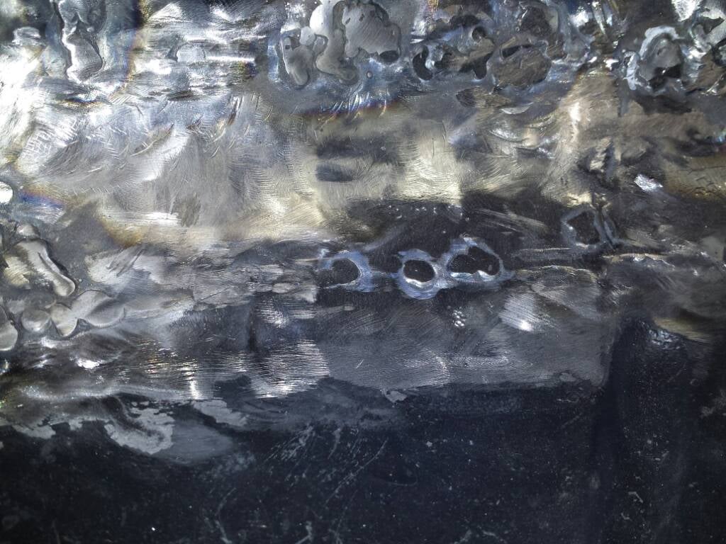

Guys, I often view this forum when I need help with my fab projects. I decided to finally join. I have a problem that I have been unable to master. This has been going on for years. I can not get butt welded sheet metal panels smooth. I either have low, pits (shrinkage) around the welds as shown in the pics, or I grind too much away, get pin holes in the metal and then burn thru a lot when fixing the holes- showing how thin I've made the parent metal.
The part in these pics is a mini wheel tub that I am expanding further. I cut an aftermarket tub and added a slice to the inner rear section where I thought it became to tight for the tire.
I originally had the tub welded up and welds ground down. I used a flap disk to grind them flush with the parent metal and then used the edge of a 3" cut off wheel on a small die grinder to make the panel look smooth. Finally I finished with a quick go over with and 80 grit 2" sand disc to blend it all together. Then I hit the welded seams with a planishing hammer. There were tons of pin holes in and round the welds. I filled those, ground them flush with the parent metal, and the product at this point is what you see in the pictures.
Again, I have never been able to master this. How do you people get these patches to fit perfectly flush so you can't even see the weld seam? Is this the result of me using too much heat or having too big of gaps between my butt welded pieces.
This tub and projects from the past have always been under my car or hidden. I want to stretch my car's fenders and make wheel flared though, so I will need to know how to make perfect butt welded seams on an exterior body panel. I'm extremely frustrated.
I am not new to welding sheet metal and especially am not new to welding in general. I'm using a lincoln sp-255 220v wire welder with 75/25 and using .030 wire. .023 doesn't work worth a crap in this welder no matter what I do. I realize .023 is best for this type of stuff but I can not get it to function. I do have a miller syncrowave 200 TIG welder and did some of this welding with that (cutting perfect shaped patches to elliminate gap and be able to TIG from there is a whole nother subject and skill I need 2 master 2!!!)), but I had up to 5/16" gap in some places on this tube, so most of it was MIG'ed with the Lincoln. Please help!!!

I have been watching a few youtube videos on the subject of this thread. I believe the pictures I have posted here are a result of me welding too much in 1 area at a time which is yielding in the extreme shrinkage of the metal near the weld. Am I correct?
On my upcoming patches and panels I will weld much smaller tacks and hop all around the seams to reduce distortion. In the mean time, what is my best course of action to fix this piece without using bondo?

You'd be better off with a 70/30 mix than using Co2 without a doubt.
If you do a lot of sheetmetal welding go with .020 wire and tips.
show some pics of the weld before you start grinding and we can be more help. my best guess is your trying to weld too cold. and yes, you cant just run a bead with sheetmetal, its tacked, spaced and tacked again. while your getting the hang of it try using a course hand file to cut down the weld. a good weld tack wont need but a few strokes with a hand file to be flush with the surface.

Cut the problem areas off and weld in a new piece.
If you want to repair a thin spot, take your TIG and hold it there for a brief moment and the micro metal will flow away until it gets to thicker metal.
Get that TIG machine out and practice. It's the best if you want nice invisible welds.

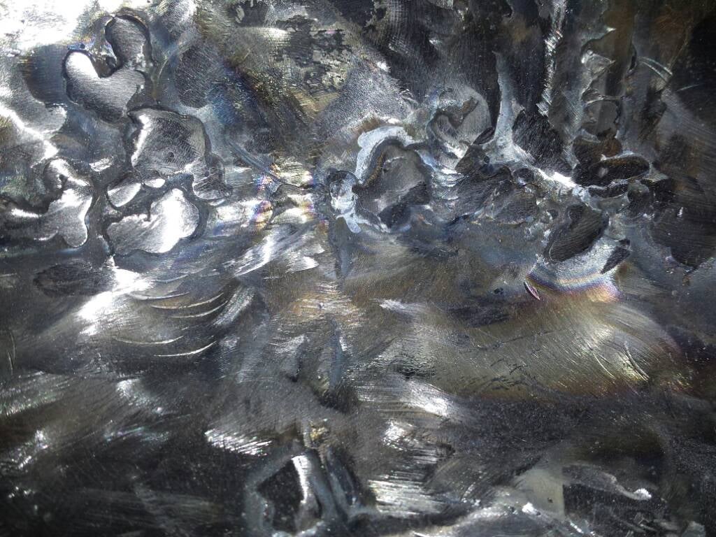

The third pic shows an area of poor tacking where one sheet is higher than the other. Each tack has been ground down with a zip disc to reveal this. It is then knocked up from the back with a hammer on dolly before welding with filler rod.
