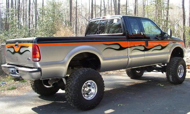

This is the most recent job I have done. This is Crossfire 15222 primer, HOK bases and Crossfire CC5000 clear.
#4 ·
Awesome Job!!! What color is the orange on the side? It looks really bright! Also, why HOK base and not Martin Senour? Do they not have as many bright colors or what? What little painting I have done, I used Martin Senour and crossfire and absolutely love the stuff. It seems really user friendly and I can get good results even though I havent had much experience. My only concern is that I can not find a very bright orange with them. Does the HOK work OK under the crossfire clear? Thanks and have a great day!

On multi colored graphic type jobs I like to use HOK because that is what it is designed for and the cost is comparable to Crossfire. I can just look at my HOK book and pick colors that I think will work together without having to reasearch 1000's of factory color chips. When an intercoat clear is needed you will be forced to mix product lines with Crossfire because they don't offer one. You have to get that from the Tec Base line to stay withing that manufacuters products and it just gets too expensive.
So for overall refinising in a factory color I generally use Crossfire Base. For panel match I use Tec Base. For full on custom I generally use HOK. I use the CC5000 clear over all the different bases.

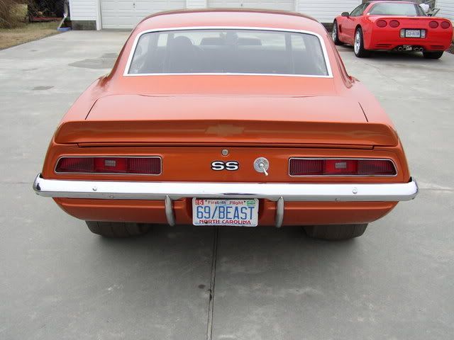

The orange in the picture is HOK tangelo pearl. If you look in my photo album the orange Nova is done in Crossfire base that I had custom mixed using Staight CF103 mixing color with the basecoat fixer and balnce solvent added in the proper ratios by my jobber.
The orange in the picture is HOK tangelo pearl. If you look in my photo album the orange Nova is done in Crossfire base that I had custom mixed using Staight CF103 mixing color with the basecoat fixer and balnce solvent added in the proper ratios by my jobber.[/QUOTE]
That nova is gorgeous!!! It is exactly what I have looking for. Was is cheaper to have this custom mixed or buy the HOK tangelo. I have always like the tangelo but wanted to stay with martin senour. Now it sounds like I may have an option. Also, how well did the custom mix cover? Thanks for all your help!!!
