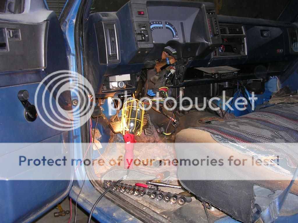

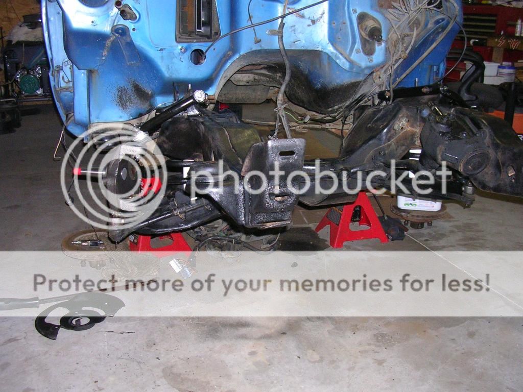

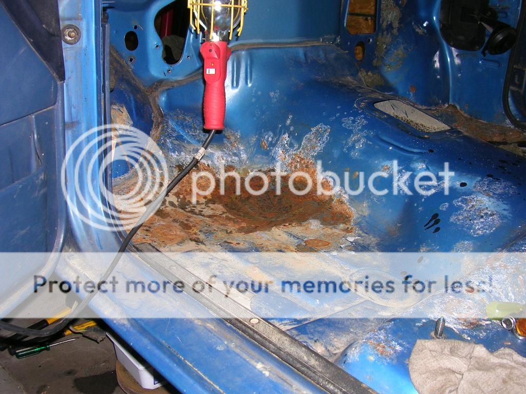

The time has finally came to start my S10 build. I am building this truck for my daily driver. A friend I used to work with bought this truck new in '88, drove it for several years, then got it a little to warm and blew a head gasket. He parked it about six years ago with the plan of having it fixed. I did try to buy it a couple of times with no luck, then one day about a year ago, just out of the blue, he called me and said if I wanted it to come get it. I didn't waste any time, lol. The truck is a factory A/C truck with a 2.5, which is now locked up, and a 5-speed transmission. My plan is to pull both of them and replace with a vortec headed 350 and a TH350 trans. I have built the motor, done the head porting myself, and my buddy Turbo built my TH350. I'm going back with the A/C, a serpentine belt setup if I can find one and if not, just go with the V-belt.
I am taking my time on this one, my body is telling me to, lol. Also, I am biding, EBay, on a used copy of "Chevrolet S-10 Truck V-8 Conversion Manual" by JTR. for some ideas that might make this easier on me, not to mention work out a little better than what i've come up with. I am now into physical theraphy again due to my legs going completely numb Jan. 29th of this year and a short stay at UT hospital. One real positive thing that came out of that experience, other than me being able to walk again, is I quit smoking. Anyway, here is where I am as of yesterday

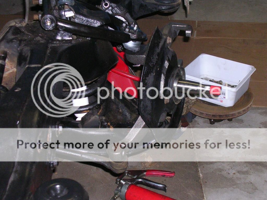

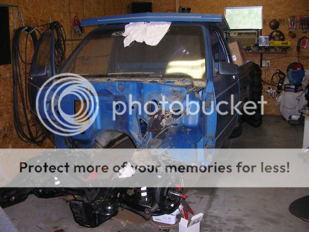

Sorry it's been a few weeks since I've posted any progress, been hangin out on s10racer. I changed my mind again, lol, but this time I'm stickin to it. I'm goin all out drag truck. I got a pretty good start on the front suspension, DJM drop spindles, Speedway tubular upper control arms w/new ball joints and new adjustable front drag shocks from Summit. I've got my front and mid motor plates on order and haven't decided on my front brake system, may just put new lines on and have the rotors turned and run the factory setup on the front for now. Here are some pictures with more to come

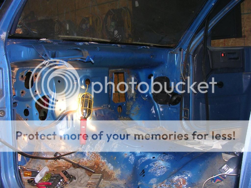

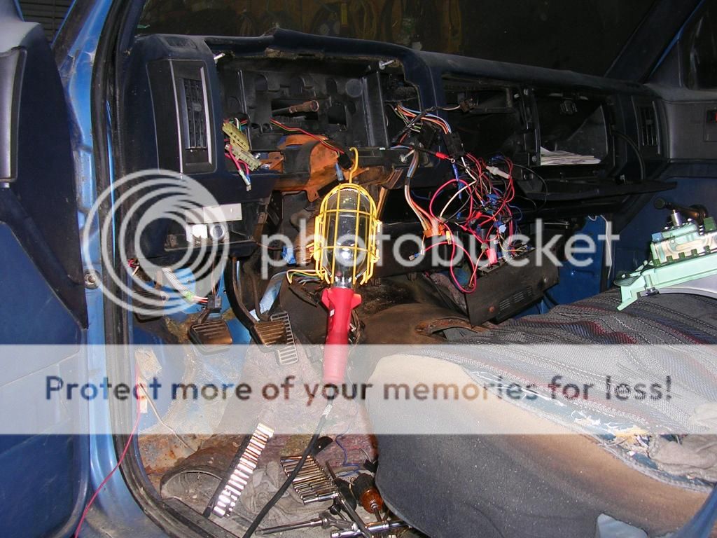

#40 ·
Then, after giving my body a 24hr. break, got the rest of the dash and interior out along with the firewall cleaned up a little. Next I think I'm gonna set my motor and trans in where I want it and mark where to cut the firewall and trans tunnel, get that cut out, then mock my front and mid plates up so I can weld the mounting brackets. My goal is to set the motor/trans back a little for weight transfer and also be able to get to the trans bolts pretty easy in case I need to pull the trans by itself. Anyway, here is where I am now
