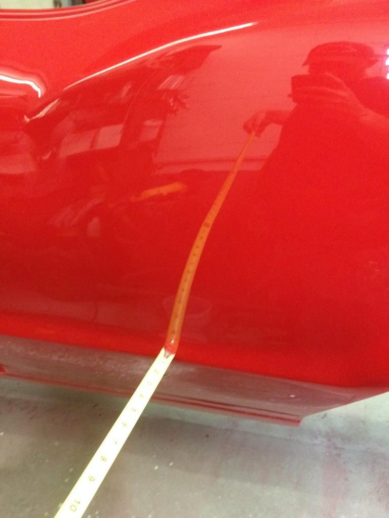

All of the SPI clears are good and relatively easy to work with. If I had to compare one to the PPG 2021, I would say that the euro mixed 4:1:1 has to most comparable "feel" to the 2021, but it sprays better and buffs better in my opinion. I usually use universal on restorations and show cars, and use euro on collision repairs. I like them both, my brother does a lot more collision repair than I do and he swears by their production clear. As for "which one to use" I would recommend the universal for anything from a daily driver to the most expensive resto being done.
Here is their dark red with universal on top
before cut and buff:
After cut and buff (the tape measure is pulled to 48"):
Kelly

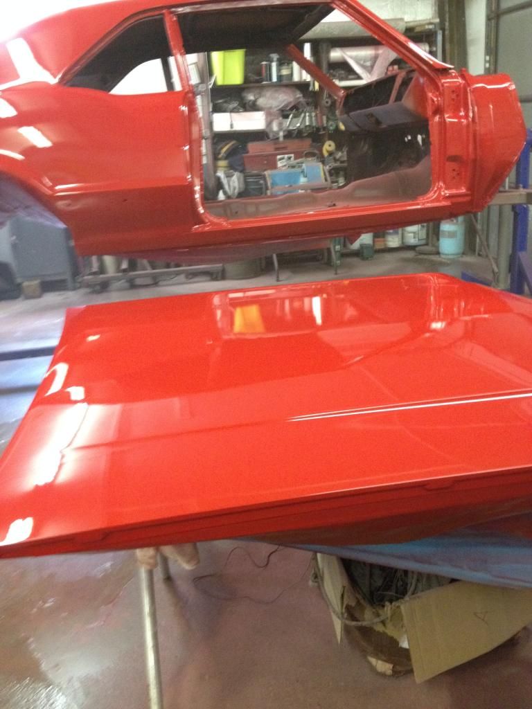

#27 · (Edited)
I'm not a pro painter (average 1 car of my own a year), so either my opinion is worthless, or the best you can get, depending on how you look at it ;)
I've used PPG DC3000 with pretty good results, and two cars with Metalux 9700 with less that stellar results (avatar Vette was one). my current project is the first experience with SPI, but I can tell you without question that I won't be using anything else in the future. It lays down and stays put, sands well, and has excellent depth. this BelAir trunk lid was shot right where you see it and had the dust knocked off with 1500, 2000 and then a very light buff.
Russ
OOps. just realized I grabbed the wrong photo. the one shown was an as sprayed photo. maybe a better example anyway.
