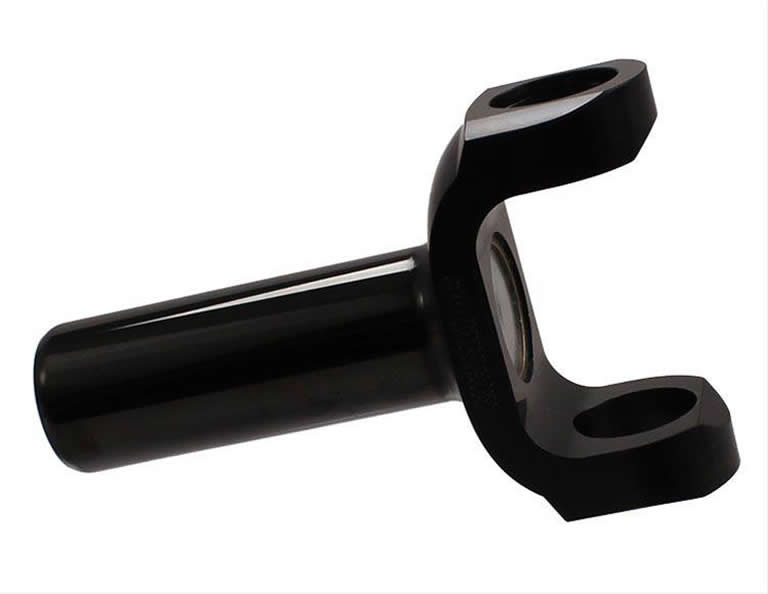

I got my Tremec TKX transmission. I have figured out which bellhousing and clutch kit I need. I am stuck on the slip yoke. The only information Tremec gives you is that you need a 31 spine yoke for it. Well, there are a heck of a lot of 31-spline yokes out there. My plan is to reuse my current 1310 series driveshaft. So what I need a 31 spline 1310 joint yoke. This right here seems to be what I need
www.quartermasterusa.com
The problem is there is absolutely no info anywhere on this specific yoke as to its journal or barrel diameter. So I frankly don't know if it will fit my TKX.
Can anybody recommend a 1310 yoke and you know for sure will fit the TKX?
FYI - I have see this particular yoke sold in kits with the TKX: Slip Yoke - T3-3-2491HP Stands to reason this one does fit. Its journal diameter is 1.685". It's not a 1310 though so it won't work for me unless I also swap my driveshaft and end yoke.
