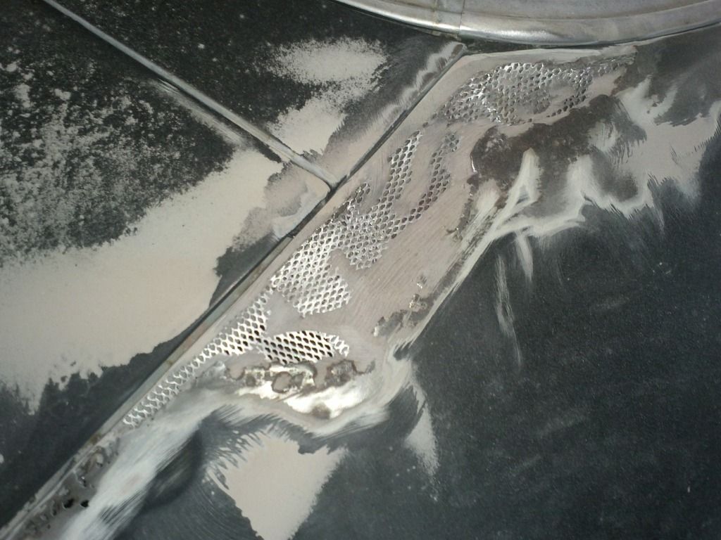

This is the back right quarter near the rear window. Yes that is mesh to hold the bondo.

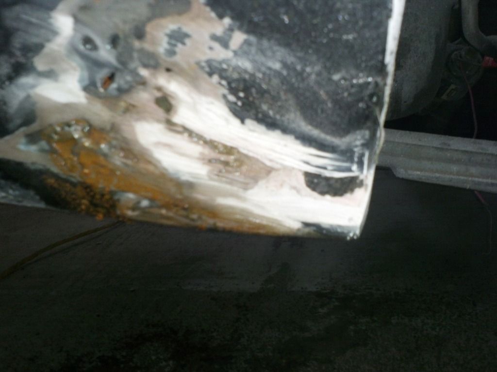

Here's the back right wheel well. It's hard to see but there's actually no metal there at all. All bondo from the bottom up about 5 inches

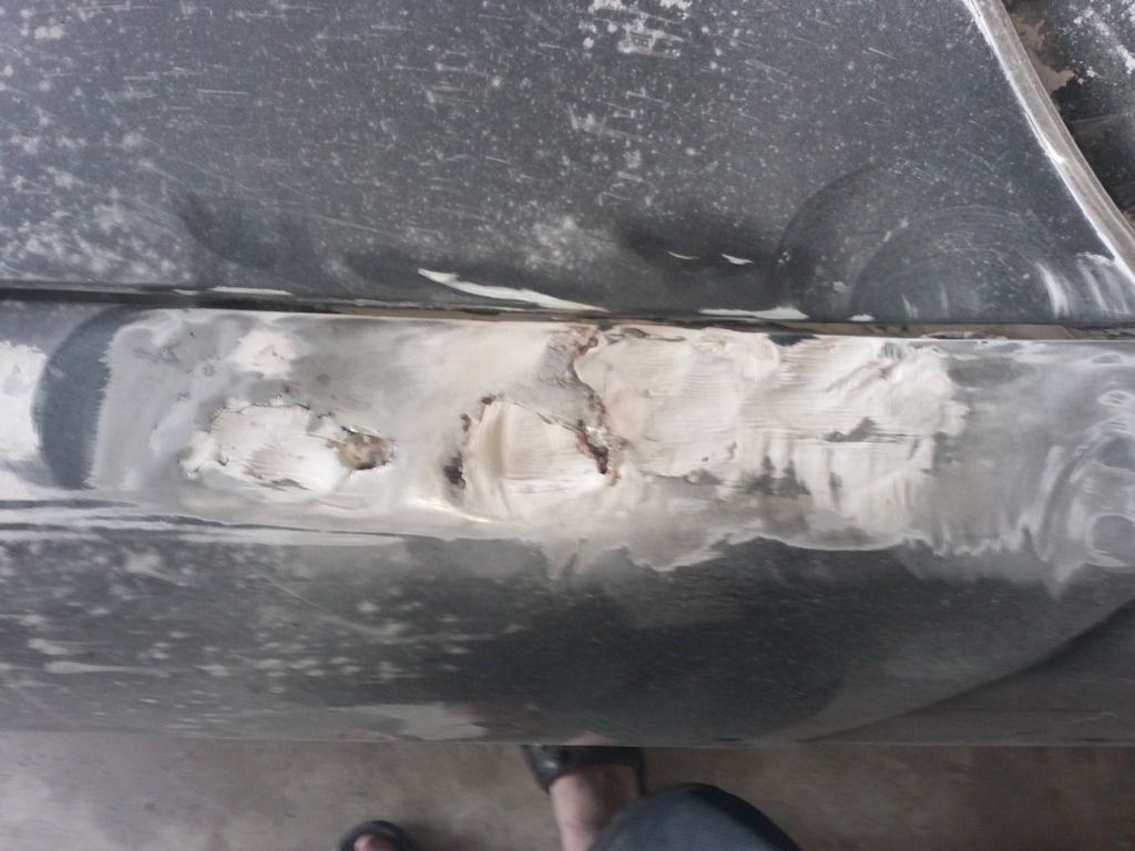

Here's the front left fender up by the hood. There's no metal here either. I know there's bondo in the lower part too, just haven't gotten there to see how much.

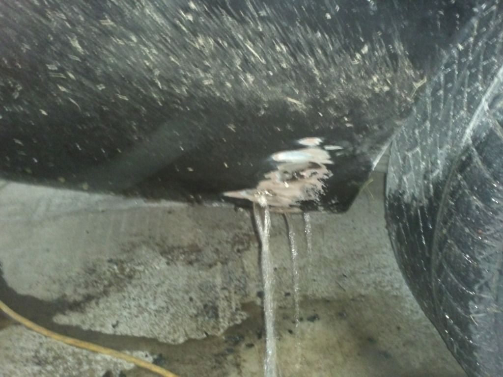

And here's the weird discovery. As i started going through the paint, ridiculously thick primer, and the bondo, a steady stream of discusting water started pouring out from the panel. A good quart of it.
Should i just buy new metal? I'm not sure if it's worth the hassle to fix. I have to take it all of anyway.

That lower quarter where the water poured out is pretty telling isn't it? That's why that spot rusted out to begin with I'm guessing. Design flaw IMO. If I were going to replace it I might want to add a drain hole if I could. Hopefully where you couldn't see it. Hard to tell from the pictures. But it looks like you might be able to just weld in some small patch panels without replacing a whole panel? Like the one with the mesh.
#10 ·
Yea i'll check it out. I also could have been because of the huge hole too since it's on the same panel. Whatever caused it i'll definitely fix.
